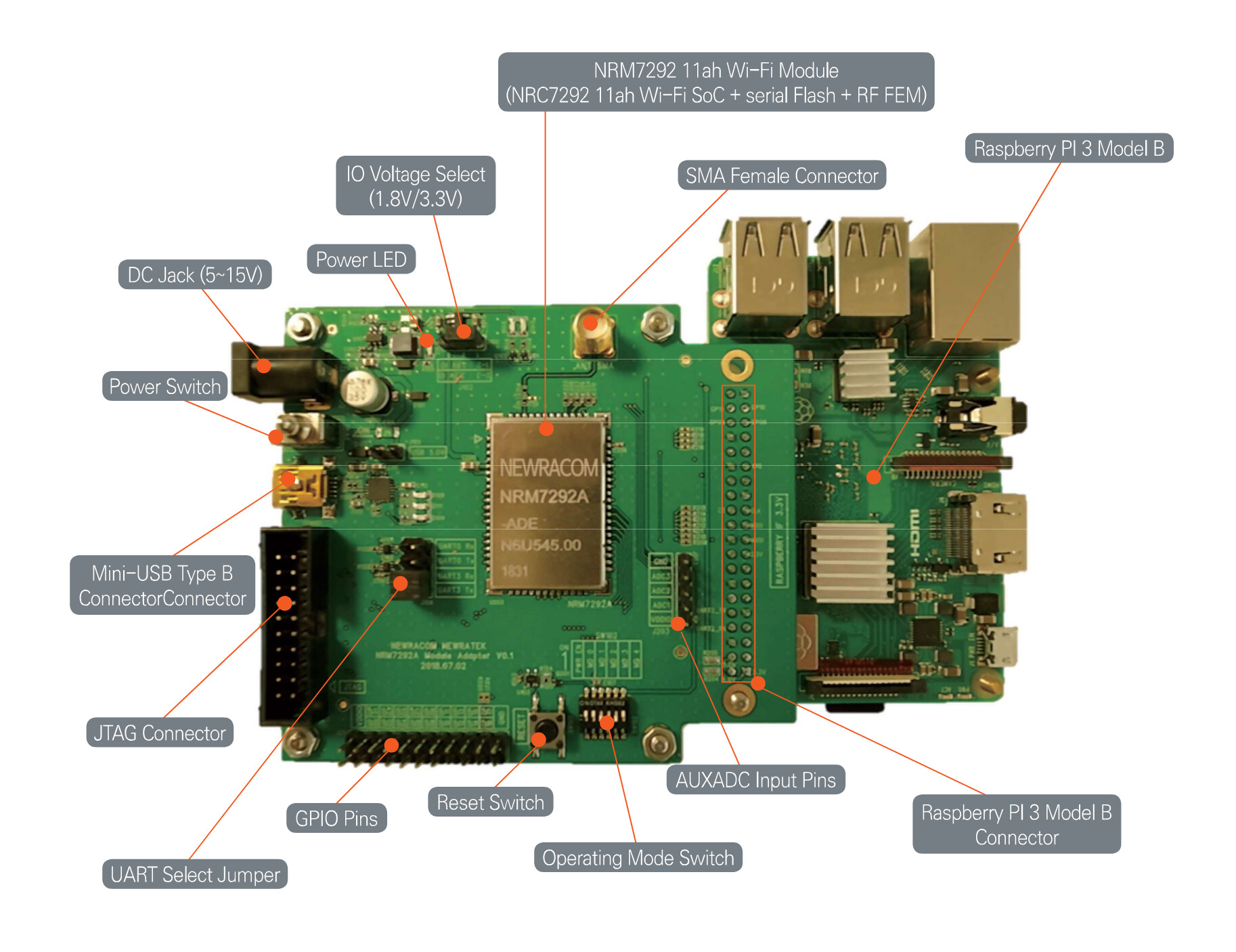

Insufficient information to do anything with. We would need the physical dimensions of the board and the pin out diagram for the connectors (neither of which are here) to make a part.

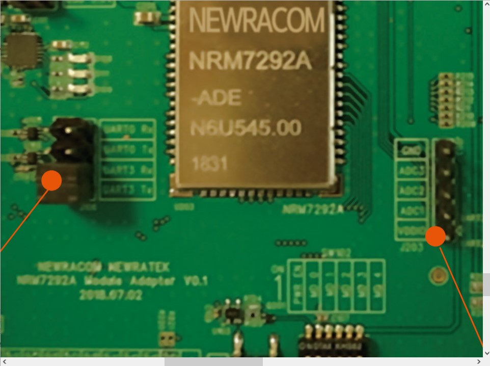

Neither of these are suitable either, it looks like there isn’t enough data available to make a part. The user manual is for the module itself, it has a picture but no information on the pin outs and the picture is not clear enough to read the pin labels
It would be possible (but not particularly accurate) to determine the size from this image by scaling it to make the RPI connector 0.1in, but that still doesn’t provide the device labels or pin out connections. The manufacturer’s web site doesn’t have any further information nor does a google search for “NRC7292 EVK” and a look at images. There doesn’t appear to be enough information to make a part.
