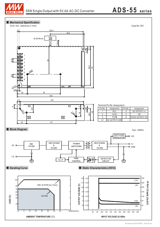

MeanWell ADS-55
imeanwell|690x388
Datasheet: ADS-55-MEAN WELL Switching Power Supply Manufacturer
Other (please specifiy) Power supply with 2 outputs
A google search of the form “fritzing part MeanWell ADS-55” indicates there likely is not a fritzing part for this particular power supply. One could be made, but there are an infinite number of power supplies available and depending on what you want to do one or more (I don’t remember any dual voltage power supply parts off hand) of the generic power supplies would likely be your best bet. A google search of the form “fritzing part power supply” should turn them up (as would a search in the forum search bar because they are mostly posted here!)
