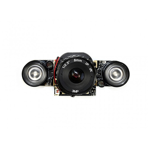

I am not able to find a part for this component - Waveshare RPi IR-CUT Camera (12076)
RPi IR-CUT Camera, Raspberry Pi Camera Module, Embedded IR-CUT, Supports Night Vision
Please can you help me. I need it urgent for my project.

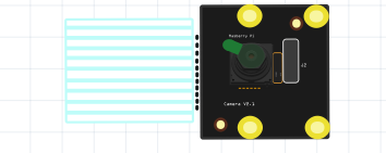

Edit: There is a RPi NoIR camera part somewhere which can be used. But if you need the exact image, then I just need to confirm if this is correct

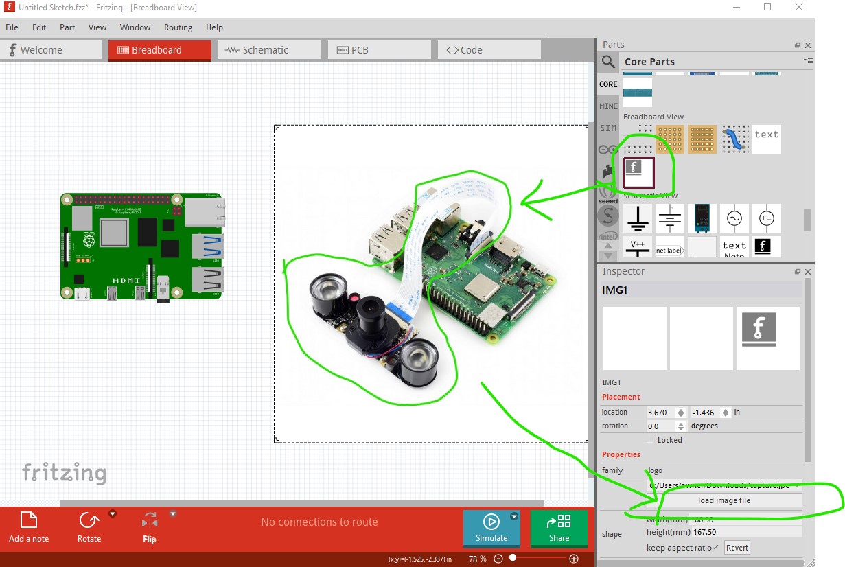

You can’t find a part because making one isn’t useful. The camera connector is not implemented in Fritzing in any of the RPI boards and there is nothing to connect the camera to. It has no connections that will show in Fritzing. You could load an image of the camera in to Fritzing using the breadboard image part like this (although you would need to find a better image than this one and align the cable with the (unconnected) camera connector.)
but that is about all that is possible.
Yes this is the one I am looking for.
Oh ok, i had found one camera RPi NoIR in fritzing. but i wanted to show the exact component i will be using for my project to my supervisor. So, I didn’t want to use that. But this idea looks good, still having the exact part would have been better to show him.
Thank you so much, this would do it I guess, to add it in for the review. If there is any chance if it could look like how the RPi NoIR looks like in fritzing, it would really help me.
Like this but for the RPi IR-CUT Camera.

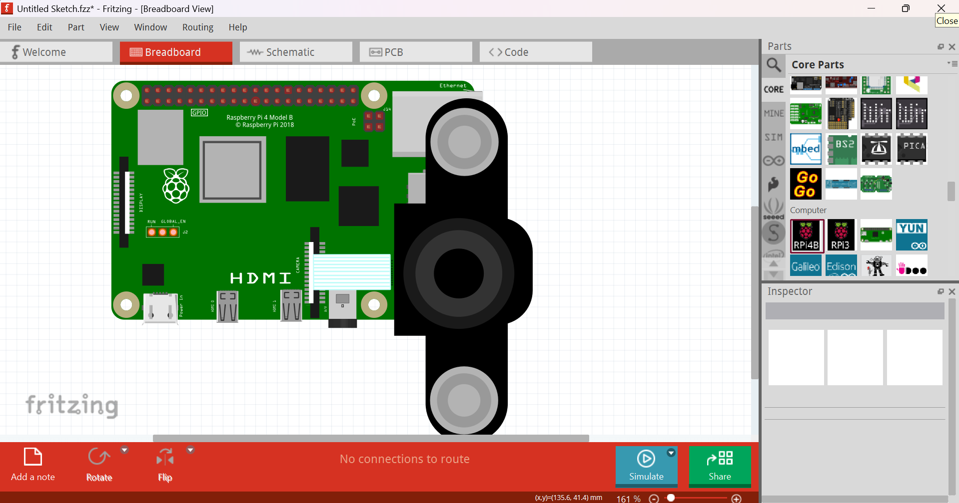

@Ghosthunterx Yup here it is
hope it helped
Yes it did, Thank you so much.
