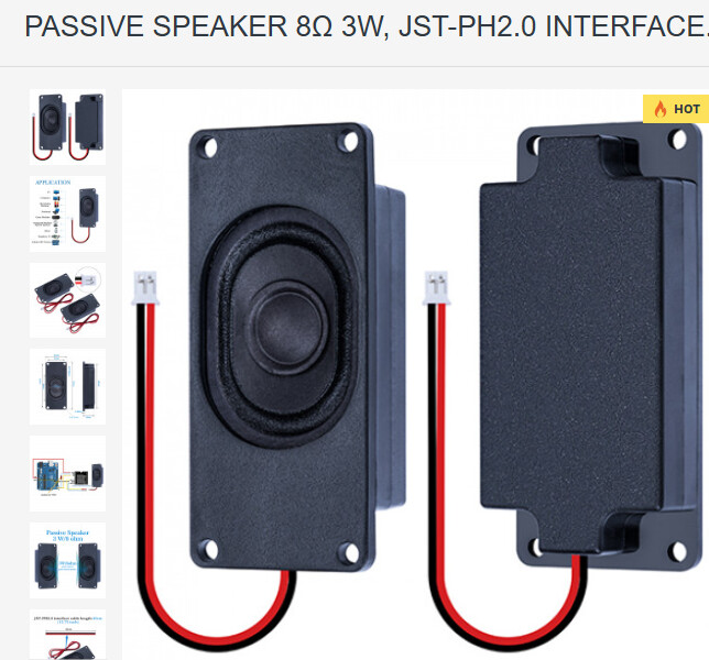

Looking for Passive Speaker 8Ω 3W, JST-PH2.0 Interface
Hello everyone, I tried to find a .fzpz version of the speakers and failed, does anybody have the speakers as a .fzpz?
TECHNICAL SPECIFICATIONS
  • Impedance: 8 Ohm Plus/Minus 15% at 1000Hz.1V
  • Power Rating: Rated Power / Maximum Power 3.0W / 3.5W
  • FO: 450Hz Plus/Minus 150Hz at 1.0V
  • S.P.L: 94dB Plus/Minus 3dB/1.0 Watt 0.1Meter; Average At1000, 1200, 1500, 2000Hz.
  • Frequency Range: FO to 10,000Hz. Average SPL-10dB.
  • Distortion: 10% Maximum at 1000Hz.1.0V.
  • Abnormal Sound Test: Must be Normal Tested by 4.9; Volts.Sine wave for 50 to 5KHZ.
  • Polarity: Diaphragm Shall Move Forward When Apply a Positive DC. Red “+” or “Marked” Terminal.
  • Operating Temperature: -25 Degree Celsius to +65 Degree Celsius.
  • Storage Temperature: -25 Degree Celsius to +65 Degree Celsius.
  • High Temperature Storage Test: 65 Degree Celsius Plus/Minus 2 Degree Celsius - 96 Hours.
  • Low Temperature Storage Test: -25 Degree Celsius Plus/Minus 2 Degree Celsius - 96 Hours.
  • Size: 70mm * 31mm * 16mm.
  • Screw hole distance: 24mm * 63mm.
  • Interface: JST PH2.0 2-Pin.
  • Interface cable length: 40cm.
  • Total weight: 24g.

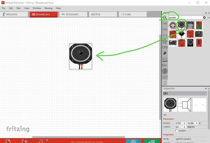

There isn’t enough data here to make a part, and probably no point to making such a part as there isn’t much to connect it to. This speaker in core parts should however do what you want.
