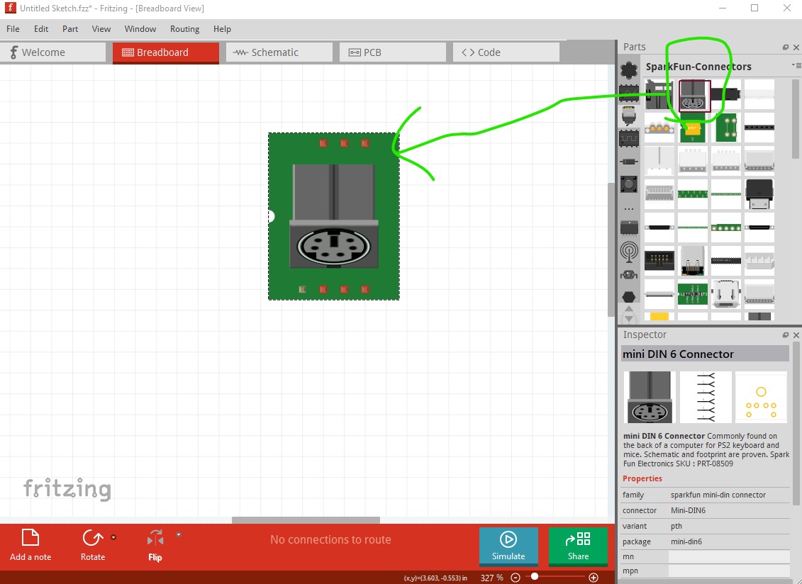

There looks to be one here
https://paulvollmer.net/FritzingParts/parts/sparkfun-connectors-mini-din6-pth.html
although it seems to be assemble yourself (as it isn’t in an fzpz file) so you would need to download the .fzp file and the 4 svgs then zip them in to a fzpz file.
edit:
My bad, it is self assemble because it is in core parts (that will be an old archive I expect.) Find it here:
