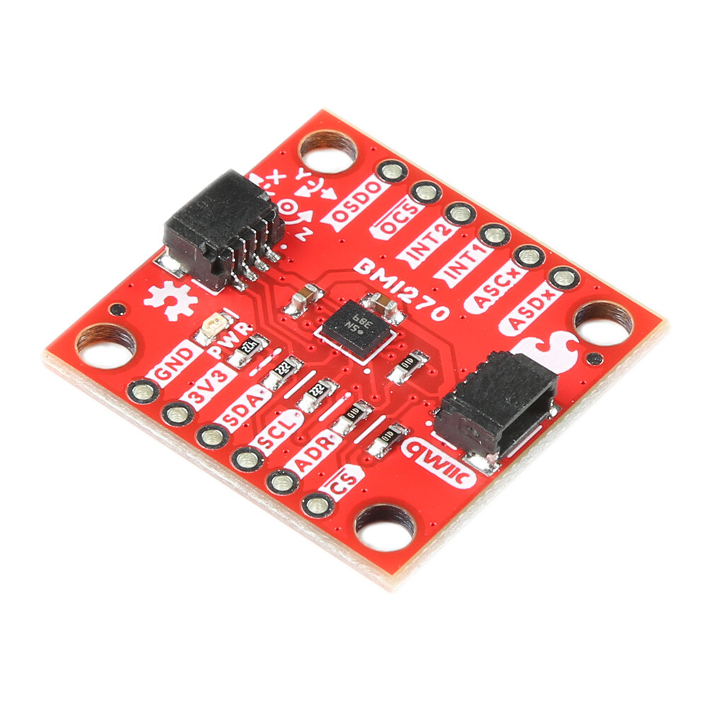

Hi, I am looking for SparkFun 6DoF IMU Breakout - BMI270 parts, I can only find the micro version. Thank you.
This part should do what you want. Of note because of the quiic connectors the pads may not align with the breadboard (if Fritzing chooses the quicc connector as the reference) so you may have to disable align to grid to allow it to connect to the breadboard. In pcb the quiic connectors are not shown (as they aren’t available on pcb) and the mounting holes are by default not drilled. If you want mounting holes you need to drag the hole part from core→pcb→hole in to your sketch, place it over the hole in silkscreen and set the size appropriately in Inspector.
sparkfun-SEN-22397.fzpz (9.8 KB)
