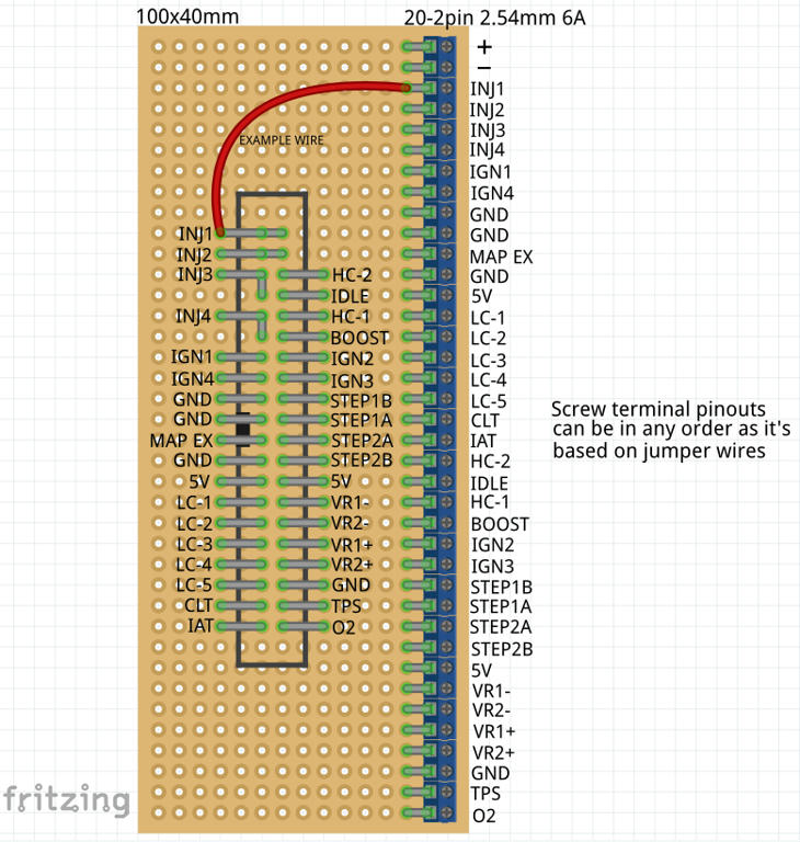

You can link and unlink pads in Strip board, but not in Pref. Does that mean I have to use Strip and unlink all the pads.
I’m not sure I understand the question. Perf board is individual holes with pad all separate. Strip board is vertical or horizontal strips that can be sliced with a knife (in real life) to get variable length traces. Why would you want to remove all the spaces and not just use perf board instead?
I wanted to show the linked pad patterns in Pref, like the underside of a PCB, so people can copy the links.
I had a play and grey wires seam ok to show solder links.
What would be better is something like Strip board where you click a track and it removes it or brings it back, but in silver.
It wasn’t a straight forward as I thought because you need transparent parts to show the solder links underneath in BB view. The shrouded IDC 40 obscured what was underneath.
This looks interesting, is there a video or howto on how to do it coming?
The transparent part was just the std part with objects deleted from the BB svg until it’s just an outline, and the rest is just grey wire looking like solder links.
