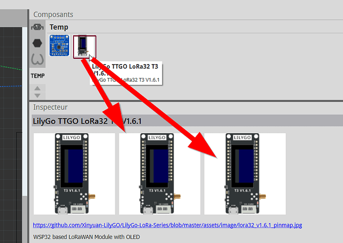

Hi
I use the fzpz file into my fritzing but I don’t have any shematic or PCB view as show in the screenshot , only 3 same T3 V1.6 TTGO
Is it a problem in the fzpz file or in my Fritzing software (last version on windows ) ?
Thanks for your help
Patrice
First it would be more useful if you posted a copy of the part you are referring to.
Pictures are basically useless. Assuming it is this one (found with a google search)
which appears likely. The person that made the part only did breadboard only not schematic or pcb so the part is operating normally. If you want schematic and/or pcb you would need to add them to the part.
