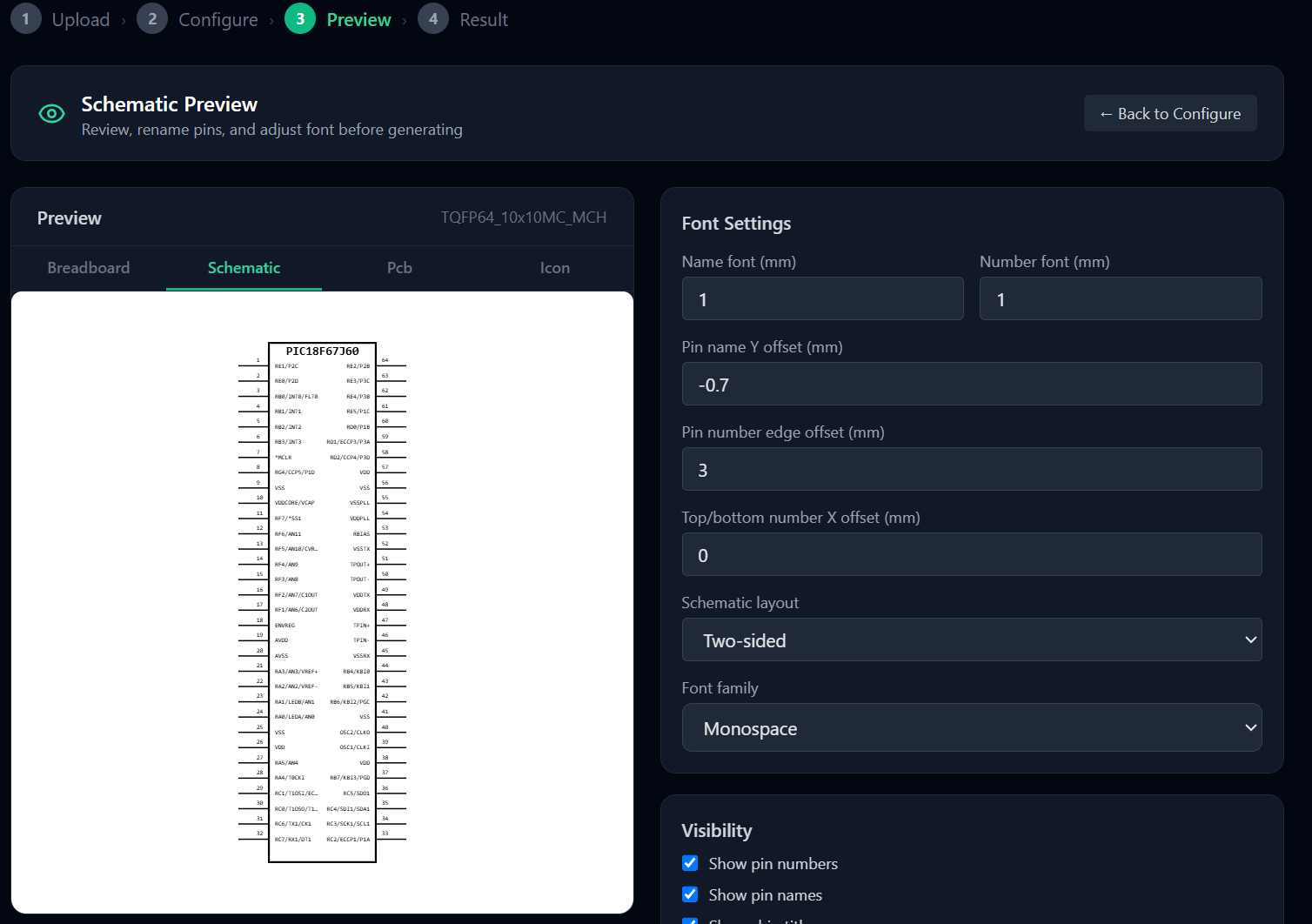

Not sure this is the right spot, but I’ve made a tool to convert 2D KiCad cad models you download from, say, digikey to a Fritzing part (schematic, pcb, etc) for easy import. It’s just a web based react native app, drag and drop stuff.
Early results seem effective, but I haven’t tested many parts. Looking for just a few experienced users to give some feedback.

Should note this is only, at this time, for IC’s. Its a bit more than just “drag and drop”, but really only requires light tweaking. Still a lot less painful than designing a part from scratch or editing an existing part.

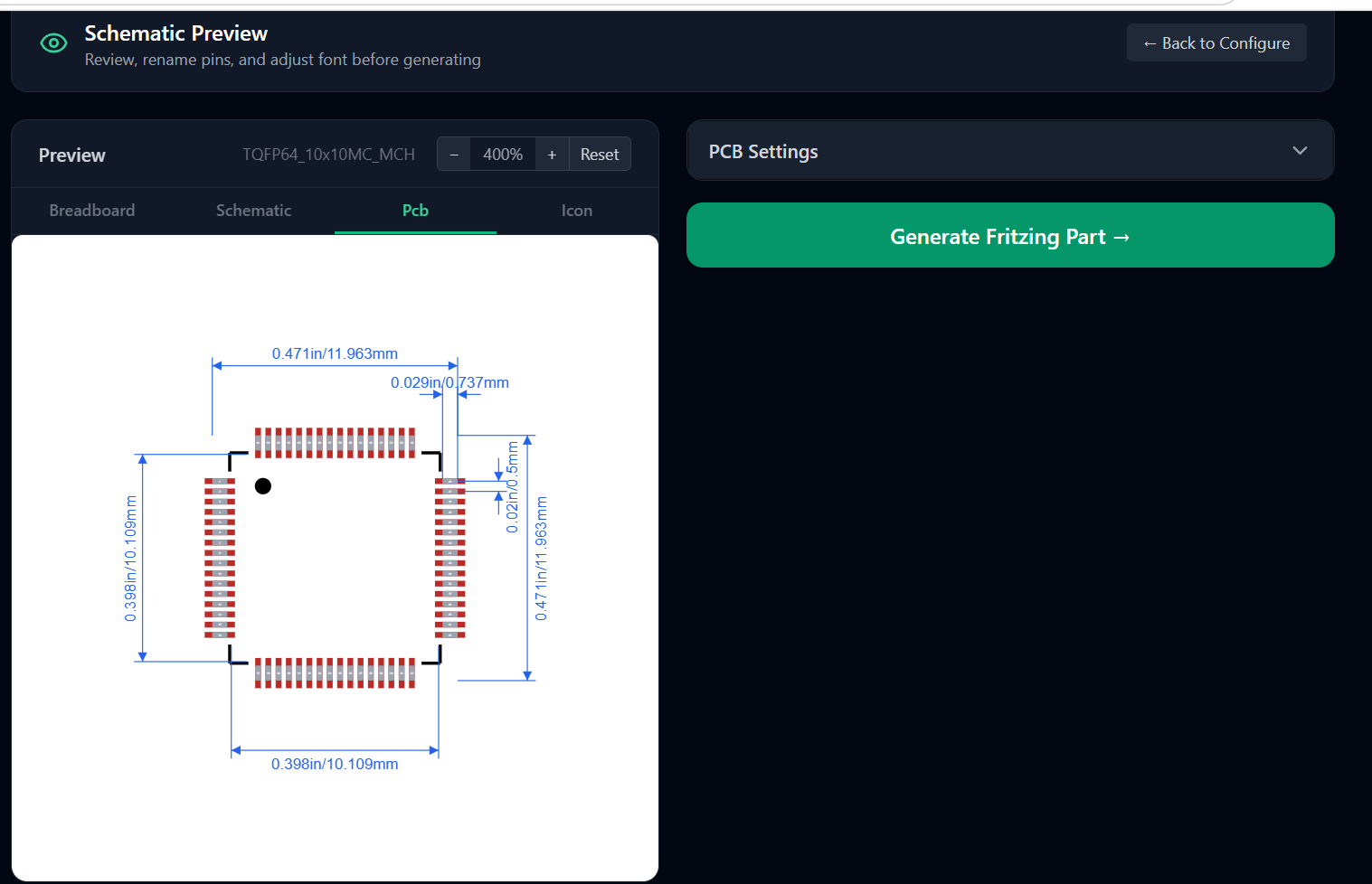

PCB/footprint behaving well. Matching Ultra Librarian dimension overlays… Will continue to refine but getting close to an almost perfect translation
