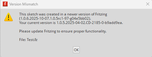

Can Version 1.0.5 open a Sketch from 1.0.6?
I sent someone a sketch in the forum and they got this error message.
Is this normal?
Regards Harald!
Yes, this is normal, and also true for all older Fritzing versions, these just didn’t warn about it.
New parts don’t exist in old version
For example an old Fritzing version will not know all the new parts we have added since then. A sketch saved with Fritzing 1.0.6 relies on all the core parts. Loading a sketch that uses such a new part in an old Fritzing version must fail, the information is simply not there.
Some features might not exist in old versions
Newer Fritzing versions have features that don’t exist in old versions. Obviously the old version would be unable to render this.
Old versions might have bugs that are fixed since a long time
There are other more subtle issues: If there is a bug in an old version, the designer using an old version most likely just worked around it.
But in the new version, we might have fixed that specific bug. Now a designer of course would not work around it. A user loading such a new sketch in an old version of Fritzing will run into the bug without warning.

We try to be more transparent, old Fritzing versions were never really forward compatible to newer versions, they just tried to silently load sketches (and sometimes fail miserably without a clear cause).
In the common case, if you have a simple sketch, no super new parts, and not a big version jump, it is probably safe to mix the versions. Just press ok and try your luck.
For complex sketches, this effectively becomes a one-way street: you can open old sketches in new versions, but not reliably the other way around.
