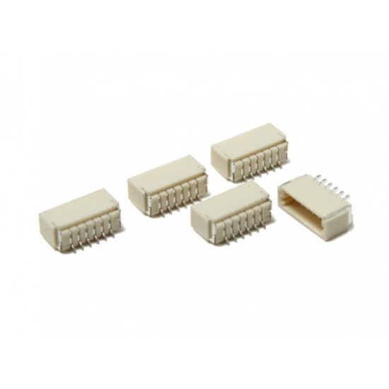

Has anyone found a JST SH 1.0mm Horizontal SMD part? 3pin and 5pin
I’ve found vanepp 4 pin one, but I need one for 3 pin and 5 pin.
Sparkfun repo doesn’t appear to have them and the qwiic connectors are all 4 pin
https://cdn.sparkfun.com/assets/1/9/5/1/8/EM406-SMDConnector-eSH.pdf
I assume horizontal means side entry (it matters because the layout is different between side entry and top entry?)
Horizontal for side entry yes.
Not vertical for top entry
These two parts should do what you want.
jst-sh-3-side-entry-smd.fzpz (4.6 KB)
jst-sh-5-side-entry-smd.fzpz (5.1 KB)
Perfect, thank you so much!
