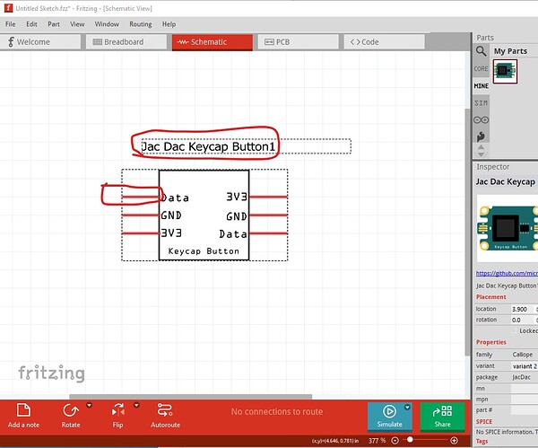

Not really any, the part works (except for pcb) so it would work as is.
There is a fair amount that should change to make a better part.

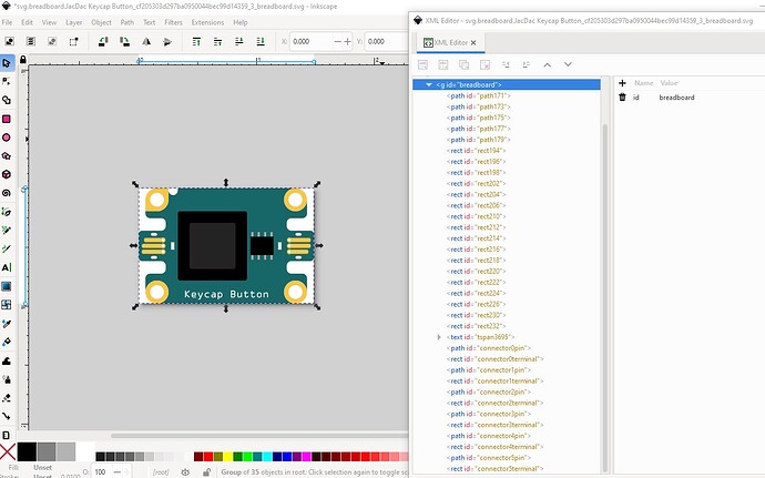

First the text at the bottom of the board is not in group breadboard and thus won’t export as an image.
Here I ungrouped the groups above breadboard to make this easier (I prefer to have a single group that covers the entire breadboard, although multiple groups will work fine.)
then move the text in to the group breadboard by clicking the indent node tab in xml editor to move it in to breadboard like this.
Then the connectors are in the wrong order, connector 0 should be on the top left not the bottom left and the pin numbers increase in order (as with an IC)
the bottom pin on the right should be connector3 not connector5
then it is preferable for all the pins to be at the bottom of the svg like this.
This allows a python script to renumber the terminals for you.

then save the breadboard svg as it is done. On to schematic. Again this schematic will work but has a few issues. The label should be A (for assembly indicating this is a module) and the pins should be 0.1in long (not the current 0.2in.)

Here the scale is set to the correct value (where drawing units are 1/1000 of an inch), the labels are all the correct colors as specified in the graphics standards document and the schematic svg is ready for saving. Now on to the pcb view
This pcb view would do, but it would be better to just not have the part have a pcb view (as it isn’t useful.) To do that we need to modify the .fzp file so lets move on to that. Starting at the top of the fzp file set the current (1.0.3 in my case and I think yours) Fritzing version by changing
