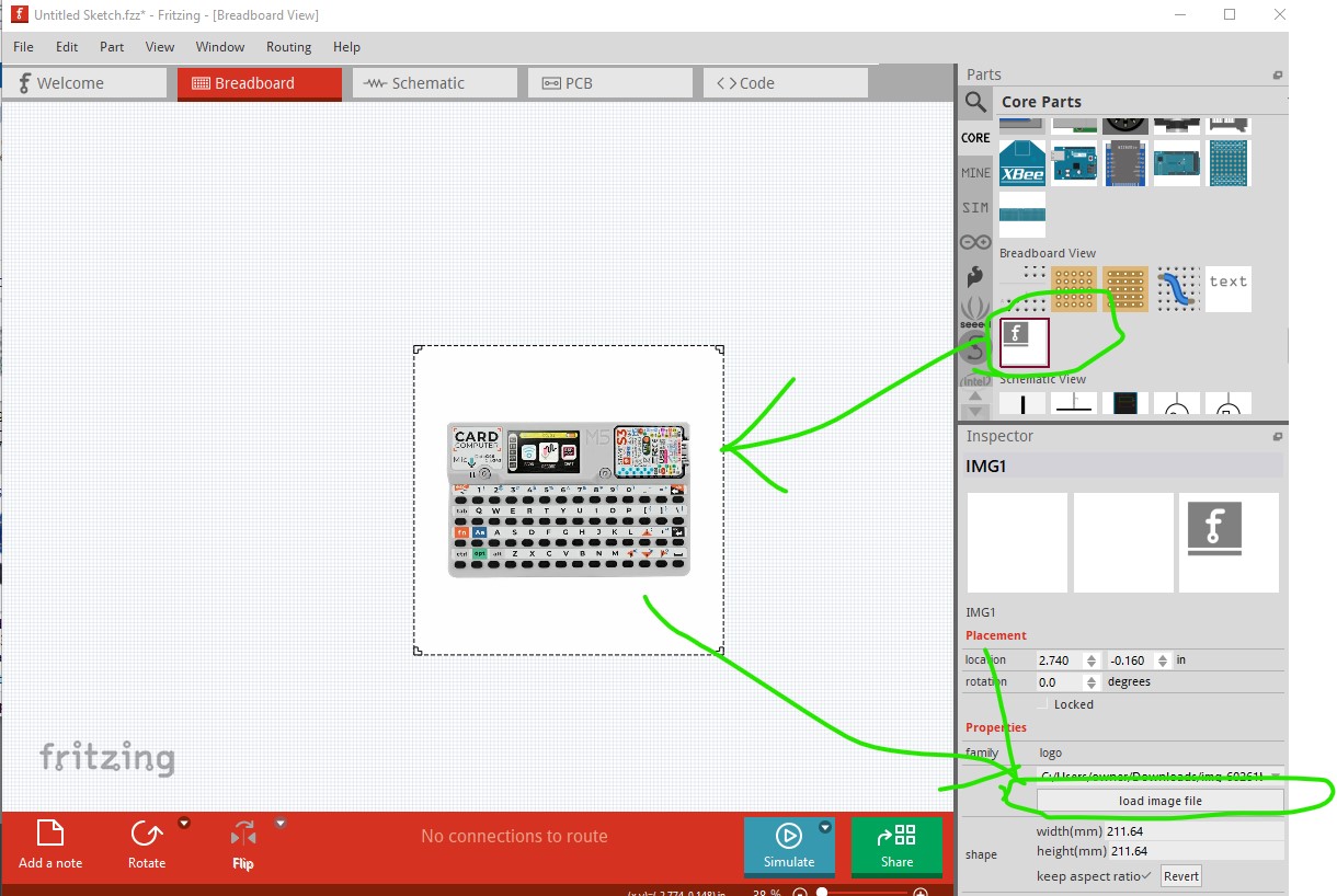

You can do that for your self with no need of new parts. First load a jpeg image of the m5cardputer from the supplied web site

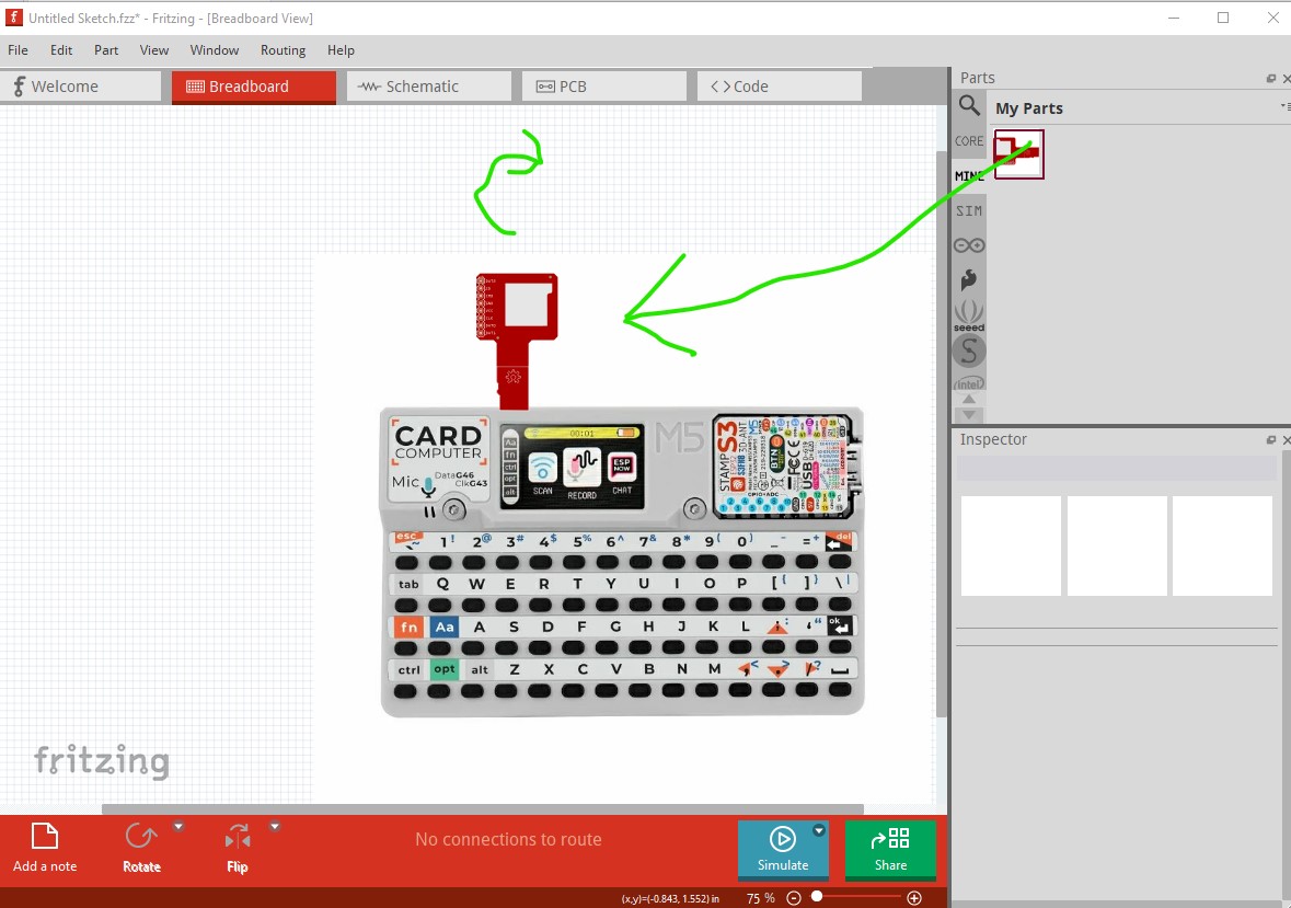

then load the referenced sniffer card and overlay it on the image like this
and you have as much of a part as it is possible to make without any new parts. Only the sniffer will show up in schematic or pcb views as it is the only real Fritzing part.
ok
but it look bad:(
