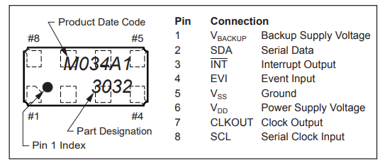

I am looking for a part for the RV3028
RV3028
I could not find any equivalent via Google or forum
image image
RV3028 datasheet
3.2mm ceramic casing
This part should do what you want. Note before ordering boards print the pcb output out at 1:1 scale (the default) and compare it to a real part as I don’t have one.

I have used your part and altered it to suit the RV3032.
RV3032.fzpz (7.6 KB)
It should be straight forward as most changes were just alterations in the parts editor (1.0.5) but if you want to have a look this would be appreciated.
Looks like it should be fine. I ran it through FritzingCheckPart.py which had no errors and it appears to load fine.
I have “prettyfied” both the RV3028 as well as the RV3032 by adding an individual icon as well as modifying the family.
