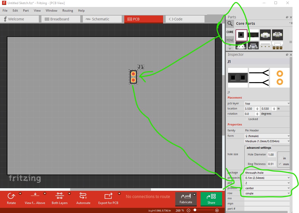

i am trying to make my custom part like and is has holes like this, but i cannot do anything —https://drive.google.com/file/d/1bVcuSlAerGk9fX_6E1l1WnAj-mL951iW/view?usp=sharing ( this is the part pic i want to make )
This appears to be a 4 pin generic header.
drag it in to a sketch, change the number of pins and set the other parameters as required.
There is no file, this is in core parts. Start fritzing and select the icon of the header on the top right in to the sketch (follow the arrow) once it is in the sketch click on it to select it and the Inspector window (the lower right window) will display the part. In Inspector set the pins to 4 (or what ever you need) and any other setable parameter and the part in the sketch will be created from the parameters in the sketch. I could make a .fzpz file of a 4 pin header (and so could you) but just using the parts factory is much easier.
