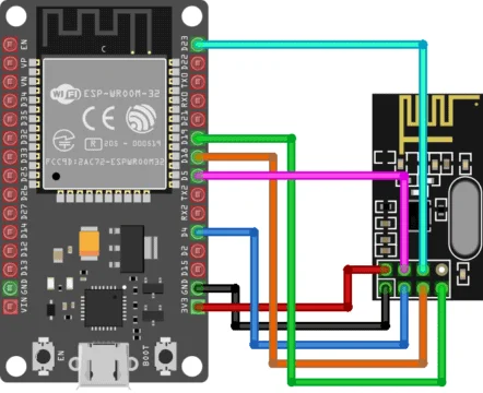

How can i find the esp32 like this?
By providing a web site where you got the image (so I don’t have to search for it) like this:
which allows me to identify which of the many ESP32 boards this is which leads to a part here:
use the DOIT Esp32 DevKit v1 improved.fzpz part because the original one has some problems.
