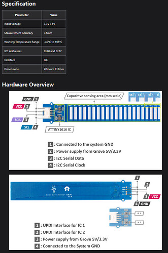

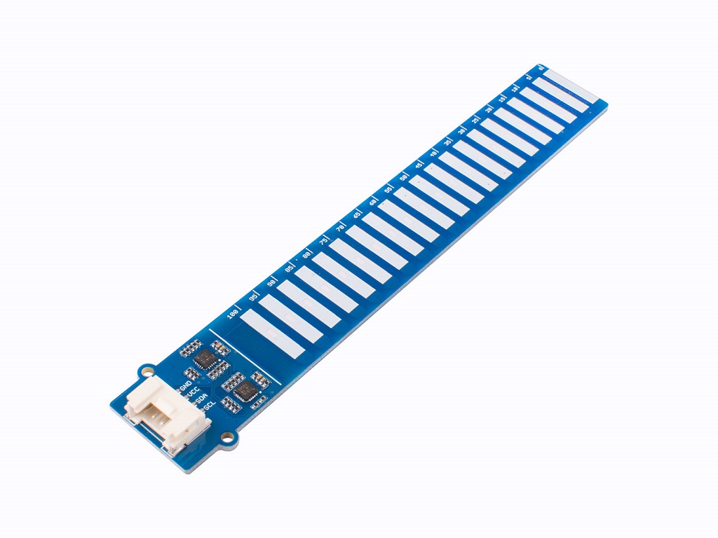

Hi, im looking for Water Level sensor that created by Grove
Hello @Shokora and welcome to the forum. This is a nice picture. I would like to know more about it, who makes it, where can it be purchased? Are there any technical details available?
Are you looking for a Fritzing part or are you trying to replicate the PCB?

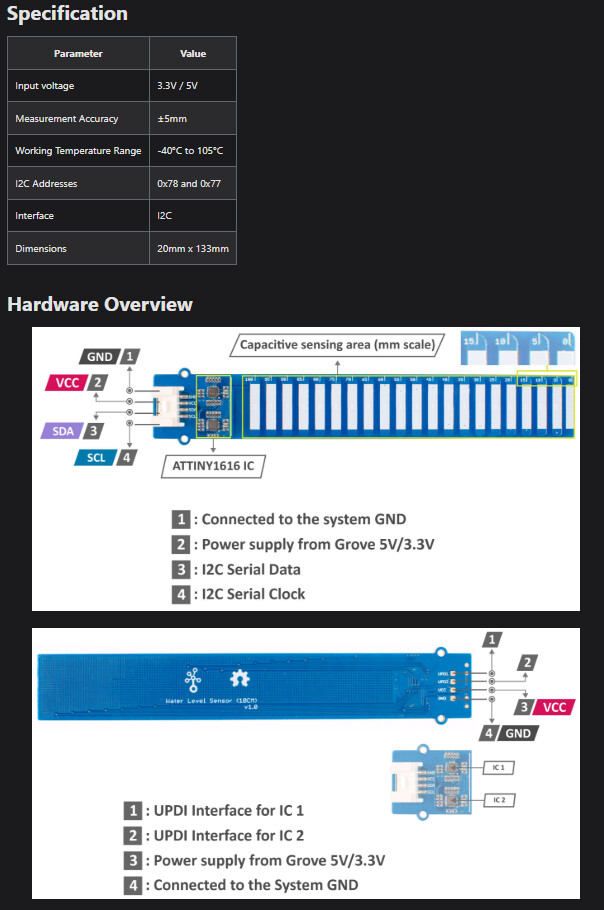

This sensor is come from Seeed Studio. Im looking for its Fritzing part. Im sorry, I dont have enough information to give at you. I only can give this…
