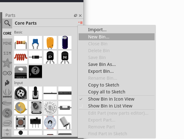

It is actually not to difficult to create one. Choose “New Bin” from the part widget context menu:

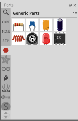

Then drag and drop the parts from other bin into the new bin:
Bins can be exported (see the context menu) :slight_smile:
generic.fzbz (42.4 KB)
