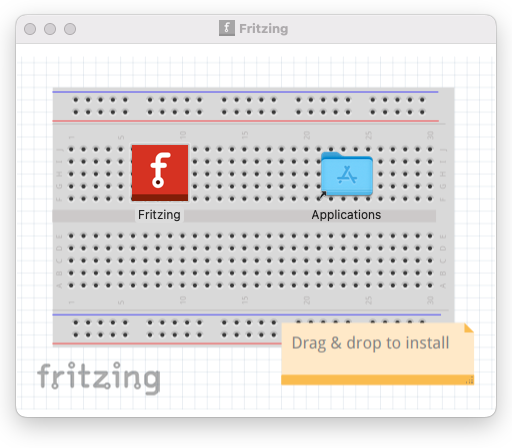

Installation works as usual, just drag and drop:

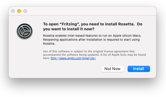

When we start Fritzing for the first time, macOS might ask to install Rosetta:
rosetta

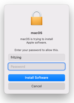

To allow this, you might be asked for your user password:
passwordforrosettainstall

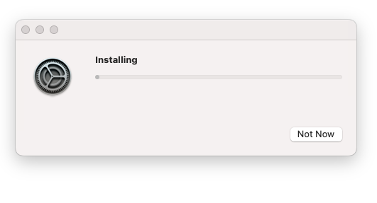

Lets say you click “Cancel”. The installer dialog will stay forever, or until you manually end it:

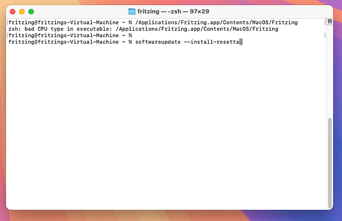

Anyway, now the fix. Lets install Rosetta 2.
There are multiple ways to do this, here we will use the terminal, and run the command
softwareupdate --install-rosetta

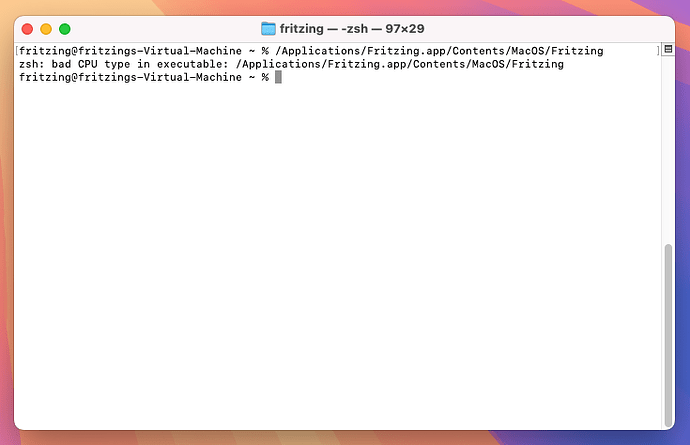

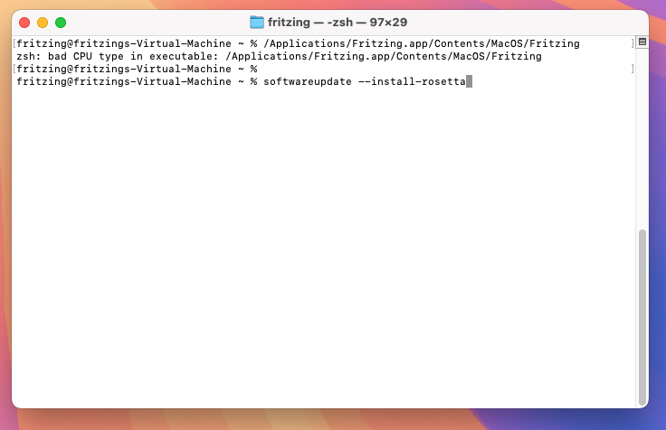

First, to check if this is really a Rosetta issue, lets try to start Fritzing at the terminal. We will see this error message (bad CPU type…):

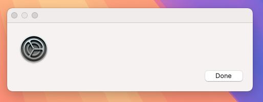

Now lets run the command to install rosetta:

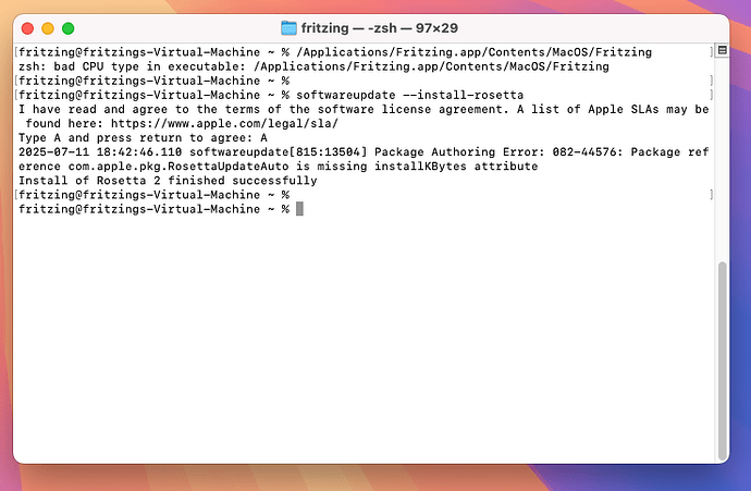

If successful, we now see:

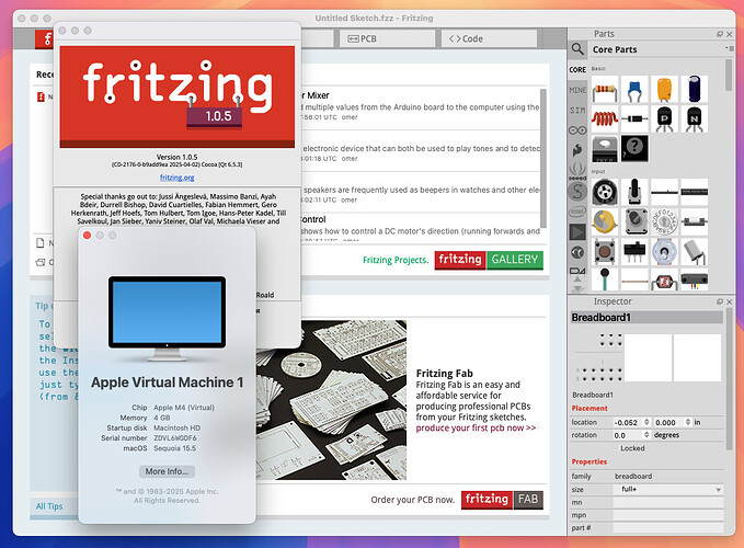

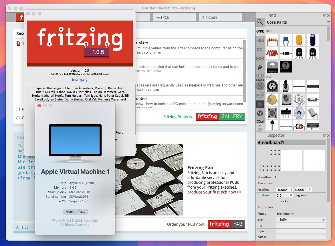

And now Fritzing will run fine:
