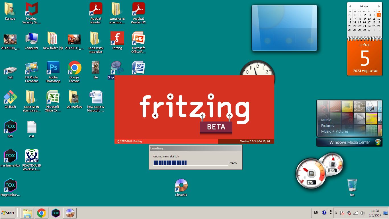

here is my issue. it freezes in 14% while loading and shows not responding.Anyone facing this? any solution?

I edited the photo and put it on my screen
