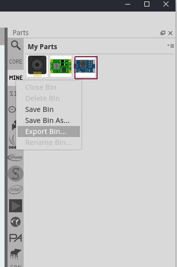

Do you really mean a reinstallation of Fritzing, or an installation on a new operating system or computer?
Fritzing stores the parts in the user directory and retains them even after a reinstallation.
Additionally, a “bin” can be saved or exported with a right-click (to share with others):

I am not sure exactly what you are asking (something may have been lost in Google translate; my German is a bit rusty), but the text below was taken directly from the Fritzing “Tips and Tricks”. Is that what you are looking for?
Local File Storage
    • The local storage folder is used for storing data that is specific to Fritzing, such as custom parts and settings, as well as temporary and long-term files that are created during the use of the software. On Linux systems, the default location for the Fritzing storage folder is usually ~/.config/Fritzing/. On Windows 11, the default location is typically C:\Users[user name]\AppData\Roaming\Fritzing, and on macOS Mojave or later, the default location is usually ~/Library/Application Support/Fritzing/.
