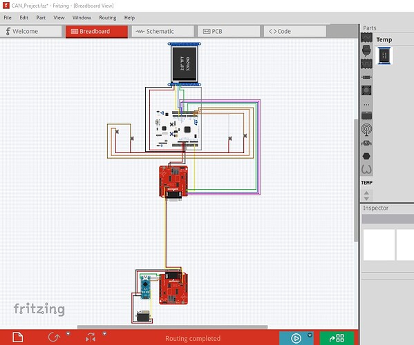

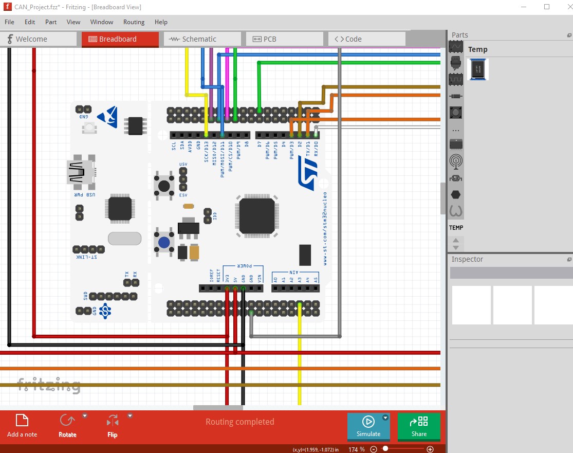

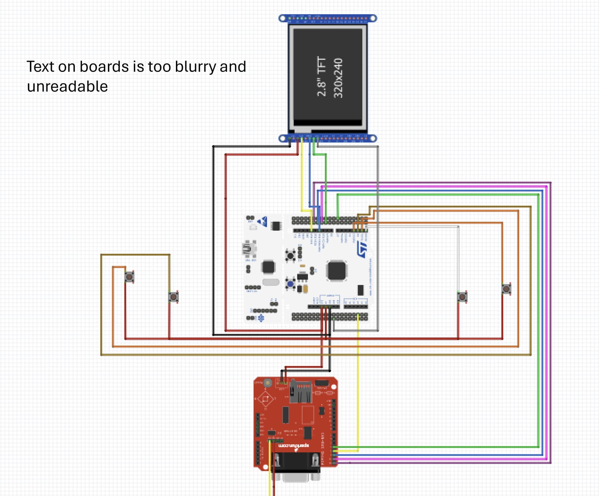

It’s not too big of a deal because the app is perfectly usable, but I feel like the parts and breadboard view are quite a bit more blurry than they need to be when using “normal” zoom levels, and only come into focus when zooming way into the part. (see pictures for clarification on what I mean).
I believe this to be a bug due to my laptop having a 4:3 aspect ratio, rather than the usual 16:9 aspect that most monitors use but I’m still posting it here in case there is a simple solution for this I’m missing.

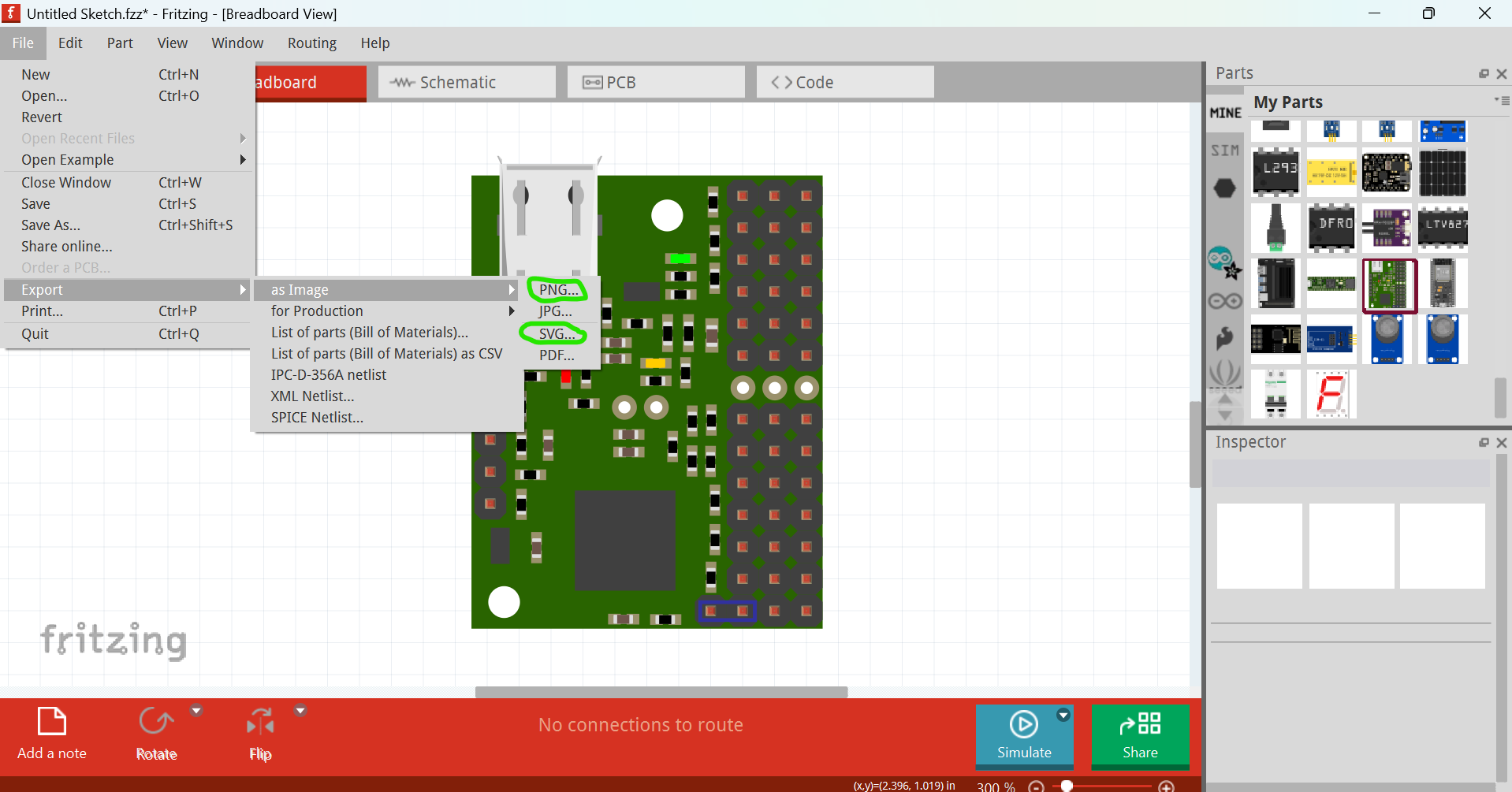

You can export as image
as png/jpg or svg

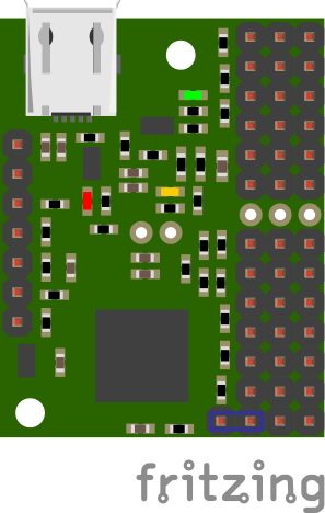

PNG
Untitled Sketch_bb
SVG
Untitled Sketch_bb
This is good to know for documentation so thank you. is there a way to make in sharper when working on the project though? makes it easier to see where to connect stuff at a glance rather than having to hover over individual pins to see which is which.

Alright, I added it just now. I think the sketch itself is fine though as it looks sharper when opened from my desktop (2560x1440) but quite blurry on my laptop (2560x1600). I honestly think it’s an issue with scaling as setting the scaling to 100% for my system fixes it, but the UI becomes so small it’s annoying so I like to keep it at 150%.
It does seem a bit blurry, but that may be mostly the size of the breadboard image. The parts all appear to be svg (it is possible to use images in parts which aren’t vector and thus don’t scale) so it mostly looks to be size. It may help if you can move the various parts closer to each other to reduce the size a bit. Here are a couple of screen shots from my machine of your sketch
Full size is a bit blurry because the grid is so small (moving the parts closer together if possible would help with that.)
zoomed out it looks fairly normal though.
