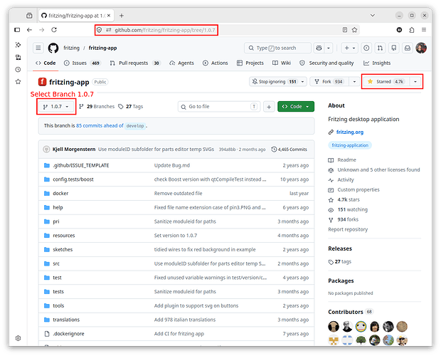

Where is the source code for 1.0.7? The github repo only seems to be for 0.9-ish. I am running on a RPi 5 (aarch64), so I can’t use the x86_64 appimage. I need to build from source.
Does this help? The default branch on github is set to developer. To change, select branch 1.0.7 in the drop-down list.
