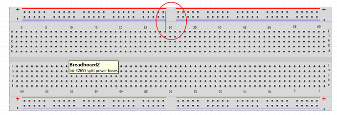

I only find bb-32655 split power buses , but the holes of the powerlines are not even with the others, they are offset.
i couldn’t find a breadboard with half/splitted powerlines which are not offset. Maybe i become blind…

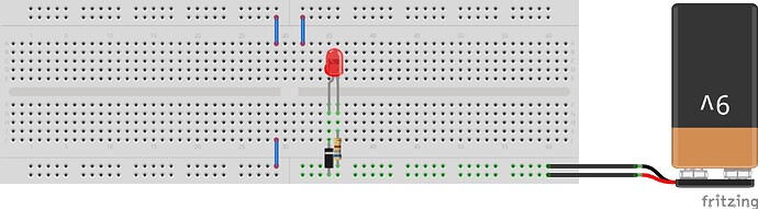

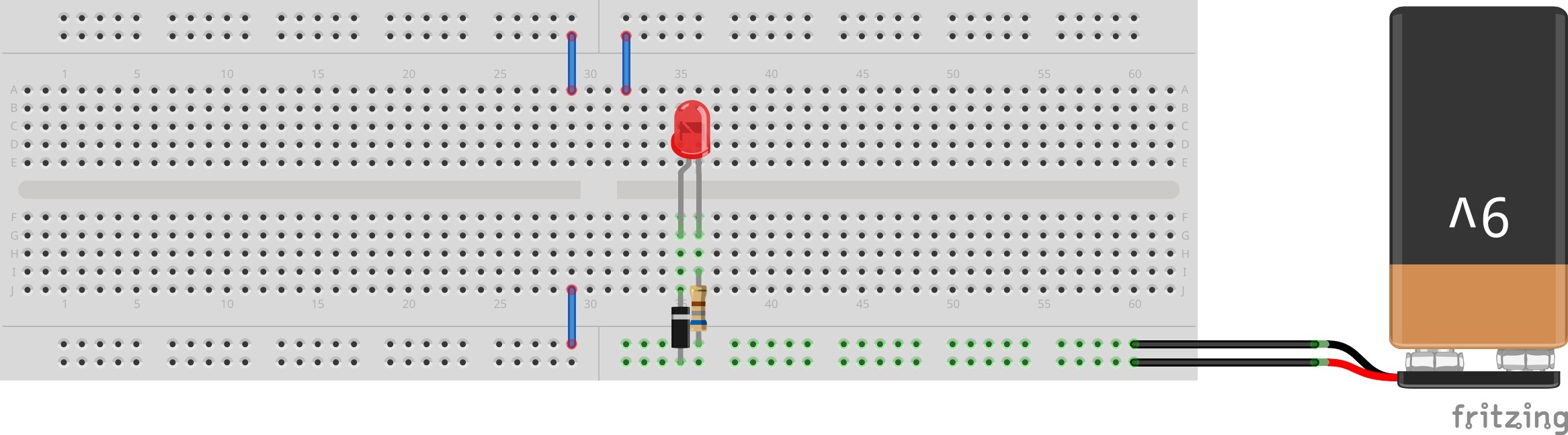

In Inspector, set size = “full”. That has a split bus, but the gap between the halves is double the distance between the other blocks of the bus lines. The “full+” version has full length bus with even block spacing.
It looks like what you really want is a “full+” version with the each bus broken in the middle, creating 8 shorter bus lines (4 each side). I have worked with that variation, but do not know of a matching Fritzing part. The “full” is the closest.

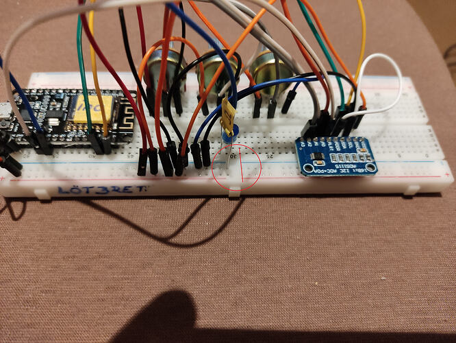

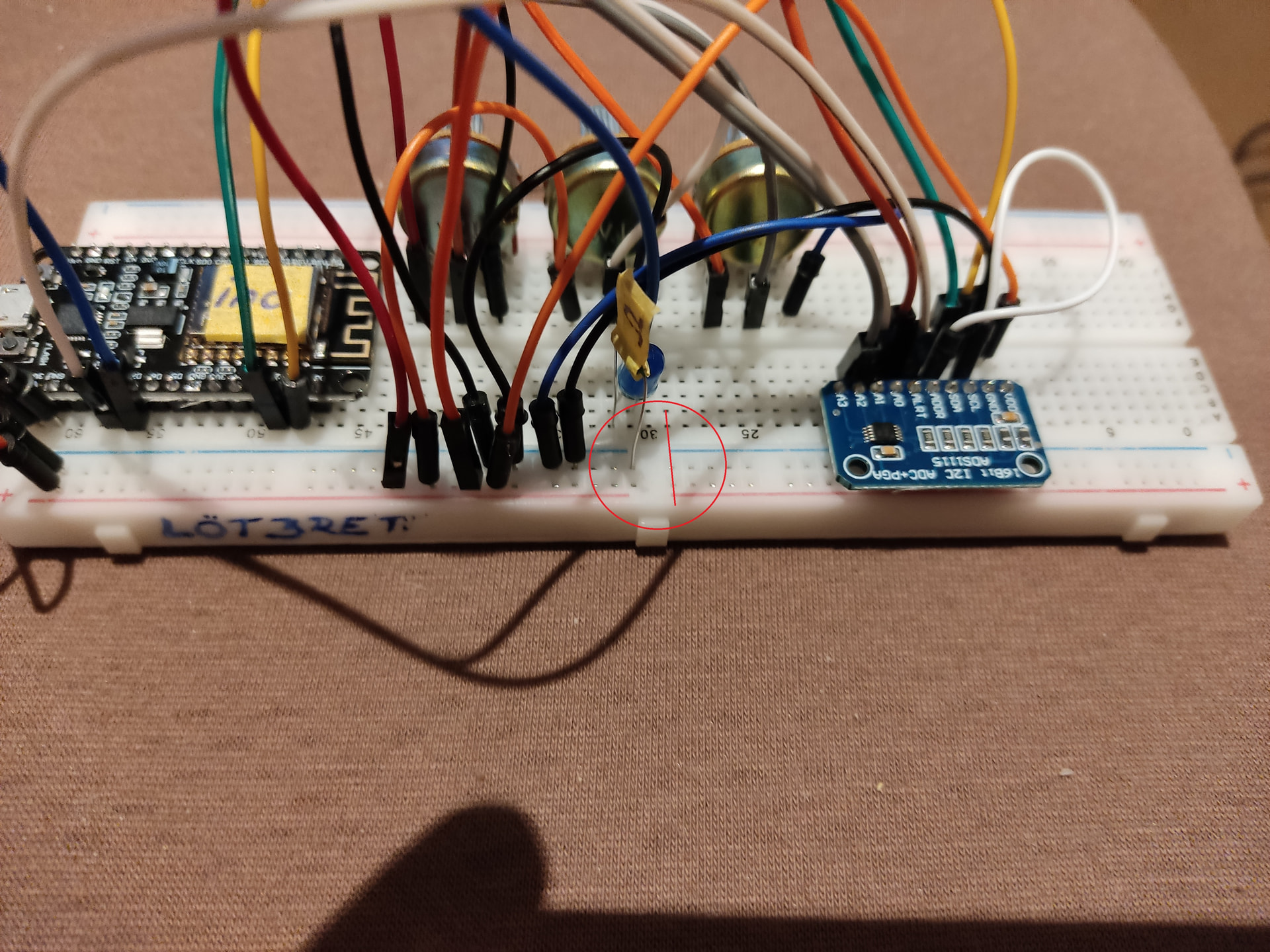

The real image is from the breadboard i use, the other image is the bb-32655 split power buses.
I hope you can see on the real image, that the powerline is splitted, but NOT OFFSET !

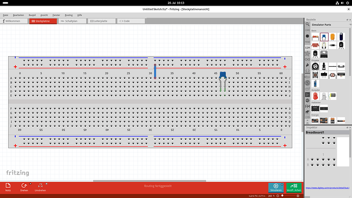

I can’t find the part at all that you showed in your graphic. Mine looks like this:
Here’s the Fritzing file as well, I’m using Fritzing 1.0.7
Breadboard.fzz (3.2 KB)
Maybe I’m going about this in completely the wrong way…

Does this part help you?
breadboard_bb_32655.fzpz (41.9 KB)
When I import it, it looks like this:
