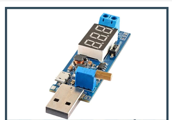

Hi sorry for disturbing you. I’m looking for a USB Step Up Module DC 5V Power Supply Boost Converter
I really need your help
First this has nothing to do with this topic and should be in parts help (which has a template which specifies the information required when requesting a part, which is essentially a web site that specifies the physical dimensions of the part and its connections, pictures are basically useless.) Please repost in the correct category with the required information.
