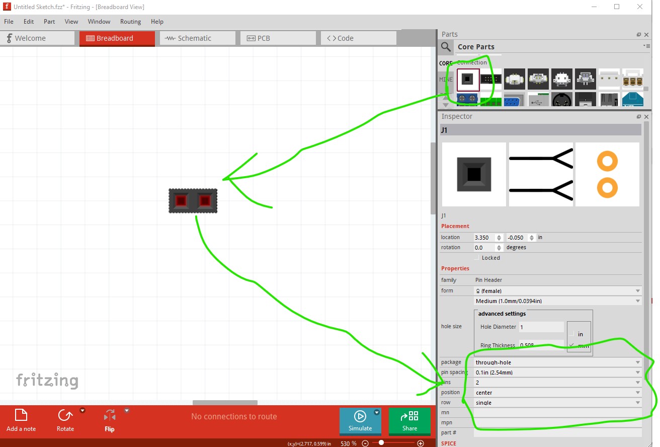

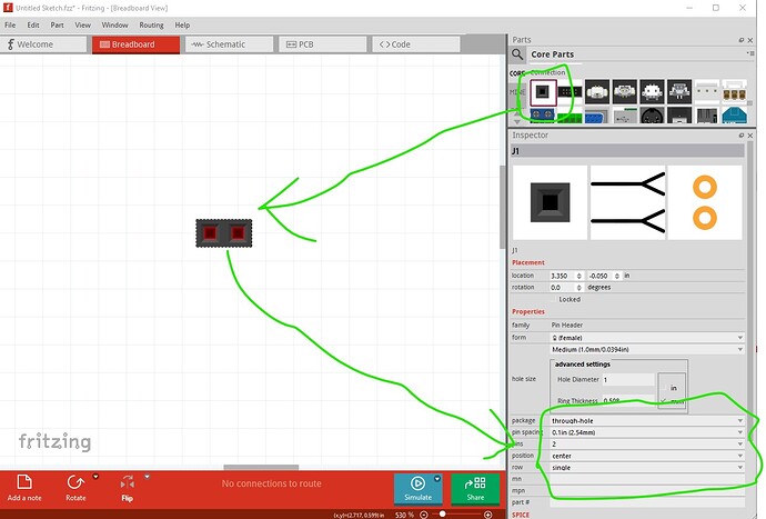

You can modify them via Inspector. You need to drag it in to a sketch before you can change it though.
once there you can use Inspector (the lower right window) to change number of connectors, sex and format.

If you get the correct connector, then it is easy…
Don’t know, why this did not show up, when I searched the partlist for “connectors”…
Only the pre-defined ones showed up then.

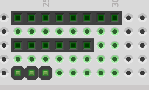

But the request would remain for parts like this:
Probably because the headers are generated on the fly by the parts factory (and thus don’t exist in core parts which is what parts search searches.)

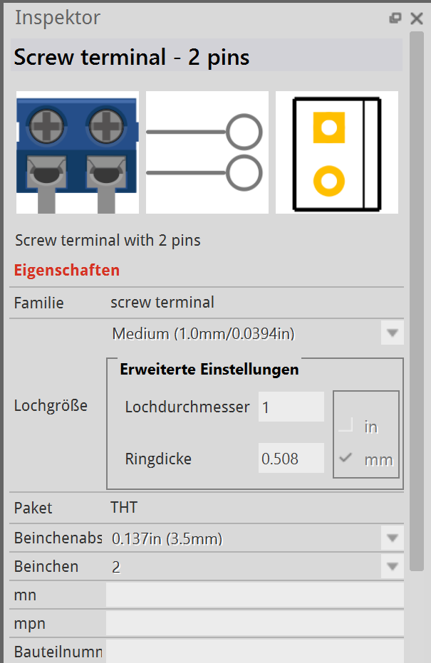

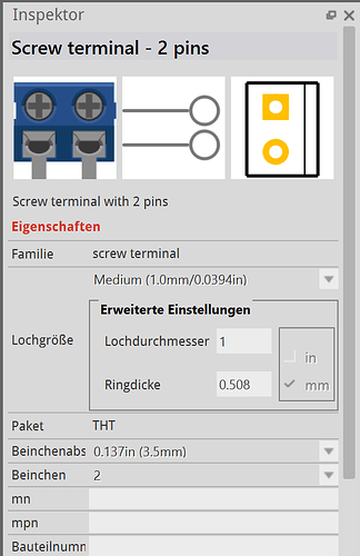

The screw terminal shown in the post above can also be ‘extended’, but changing the number of pins in inspector once the part has been placed in the sketch. Searching for “terminal” brings that one up at the top of the list.
