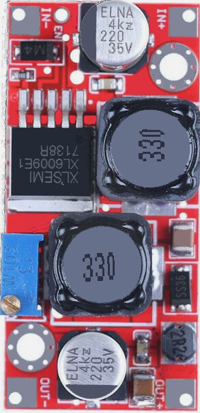

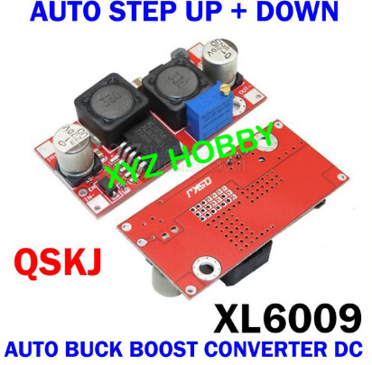

Hii, so sorry can anyone help me making this module on fritzing?? (the red module one)
Size 25x14x48mm , link that i hope can help

If you have the part already then you could take a snapshot from above and provide measurements for holes and connectors.

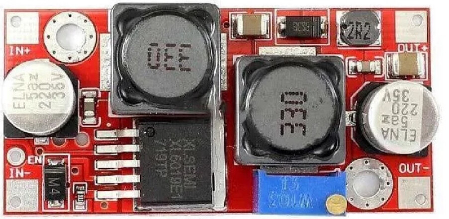

The right hand side is the suggested version, which appears to be a different board version and seems to lack the EN pin but otherwise matches. This EN looks to be just another IN- as I cannot see a sufficient separation to be an enable pin. Although in some of the pictures it looks as if it could have a separated track going somewhere.
Without actual measurements for holes and connectors there is pretty little that can be done I think.

Using the pictures I have found I get a stretch factor of ~2.07, which suggests that the board either is 23mm wide or it is not 48mm long. Measuring holes and components does not suggest that those are stretched.
Edit: Using a 48/25 = 1.92 stretch factor distorts holes and components notably.
