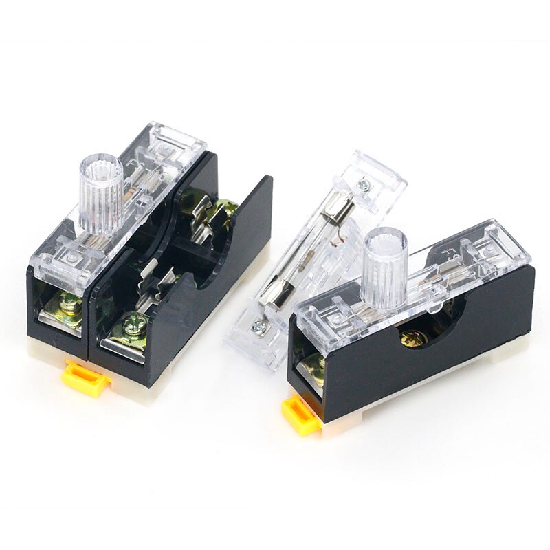

I’m currently working on an integrated iot project with industrial component and need to include a DIN rail–mounted cartridge fuse holder (6 x 30 mm type) in my Fritzing schematic
I’ve searched through the Fritzing parts library and online repositories (including GitHub and Fritzing.org), but couldn’t find a ready-made part that matches this specific fuse holder type — the one commonly known as “fuse kubur” in Indonesia.
Here’s what I’m looking for:
If anyone has a custom .fzpz file for this component, or knows a good source where I can download it, I’d really appreciate your help! :folded_hands:

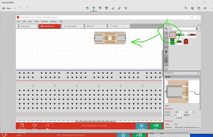

Not enough information here to make a part from (and I expect there currently isn’t one, there are fuse holders around, this one in core parts should actually do what you want though)
It doesn’t show up in a search for “fuse holder” because it is tagged as fuse handler (which doesn’t match) but does show up in a search for fuse. It isn’t a din rail but that shouldn’t matter much it has the necessary connections and is a fuse and what looks as if should serve (and it won’t mount on a pcb I don’t think, so pcb view doesn’t matter.) While I custom part could be made, you would need to provide a website that has the physical dimensions of the device you want (and a quick google search turns up a site that looks like your part, but it doesn’t have dimensions.) There are an infinite number of fuses and fuse holders so we generally need to use generic parts rather than try and make all of them. Hope this helps.
