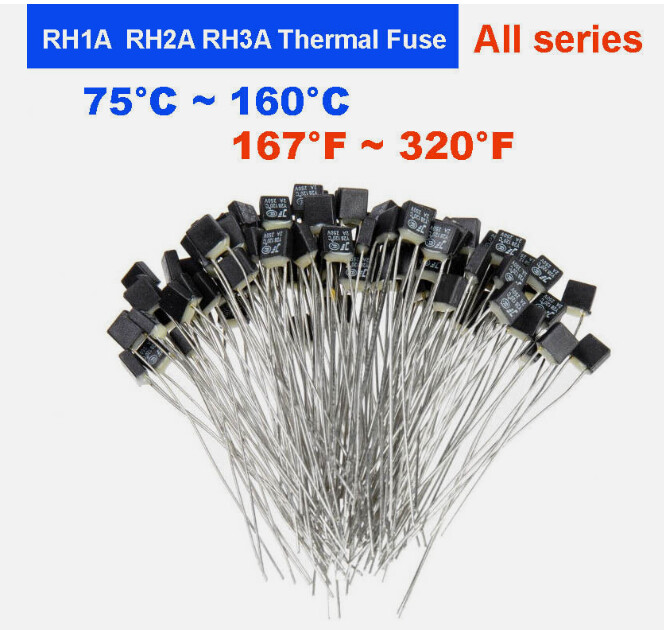

The level of protection of the circuitry is quite comprehensive. What I personally don’t like is bare life wires on a board (It might be me, who has to work near the board again, also tight casings are prone to have things touching that should not). There are thermal fuses available with bottom entry like these:
Note that your thermal fuse should at least be able to carry the current that your fuse is rated for.

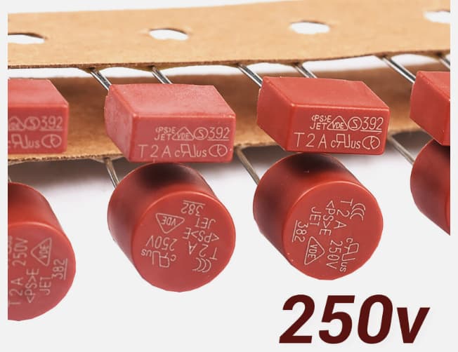

Other more space saving options, whilst remaining touch safe, are available too. Like these (TE5, TR5):

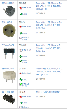

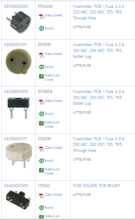

Even fuse holders exist for them
