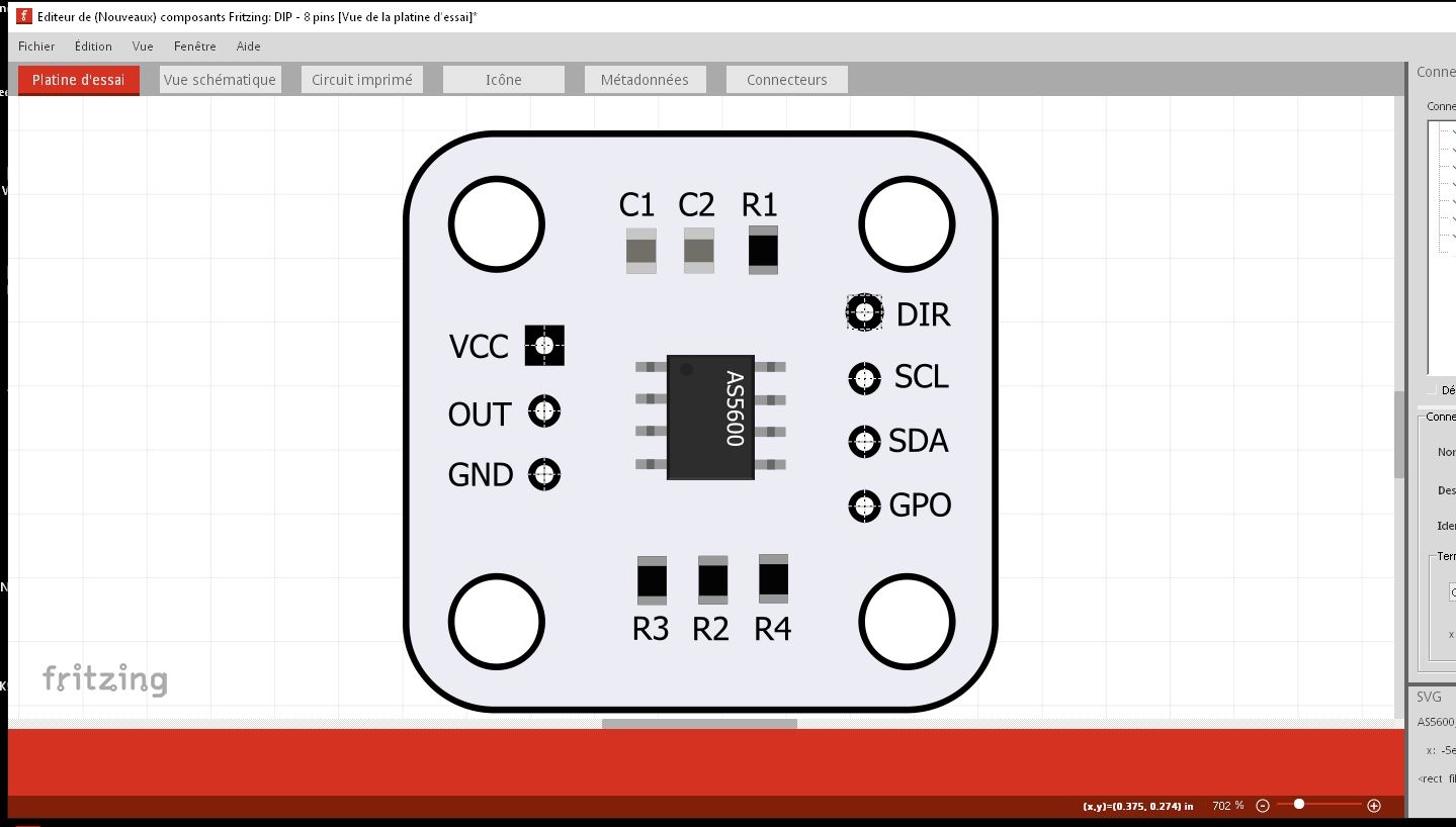

I created a component for my AS5600 project. On breadboard windows, it’s ok (pinout are correct)
But when i’m trying to create “shematic” it doesn’t work correctly… no way to have the 7 pins assigned despite having named the “object properties” in inkscape… :face_with_diagonal_mouth:

Your schematic should look like this (the pin numbers may be wrong here though)
schematics-fixed
right click on the image above and select “Save image as” to download the actual svg. Typically the resistors and capacitors are not shown in schematic just the pins for the part like this.
It’s Work very well (I just change number pin)
Thank you very much!!!
