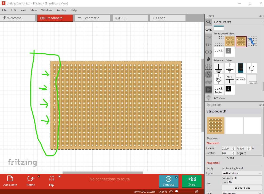

My objective is to use Fritzing to layout on veroboard. Can I just ask, when you are looking at the veroboard in design view, I assume youre looking at it from the top? When it comes to making the physical board is it possible to view from the bottom so track cuts can be easily read from the layout?
Cheers,
Bill

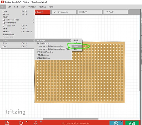

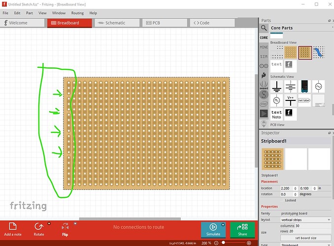

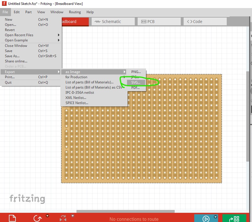

I assume design view is breadboard view as that is where veroboard is, and no you can’t view from the bottom in breadboard (only pcb view where the veroboard won’t show.) You could export the breadboard view as an image and then flip it horizontally or vertically to give you a bottom view, but that is about it I think. It would look like this here I made some cuts in the first column
then exported it as a svg file

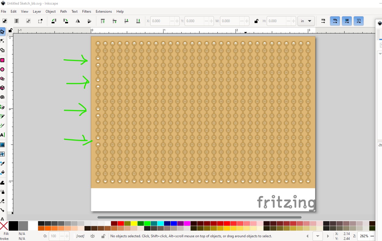

then displayed it in Inkscape which starts out same as breadboard

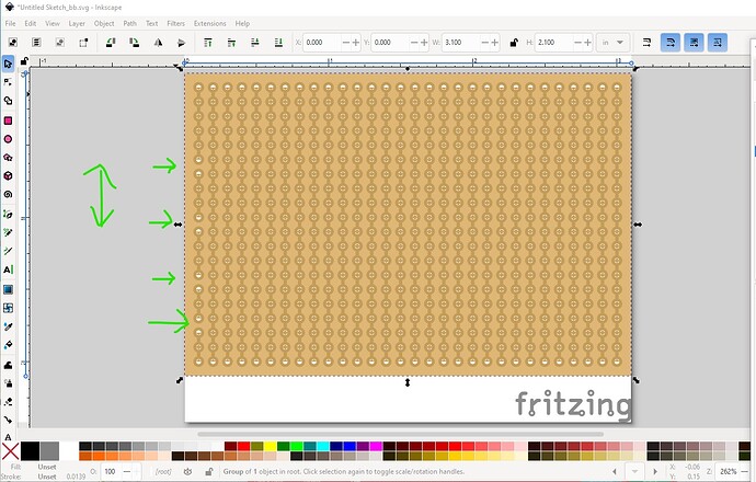

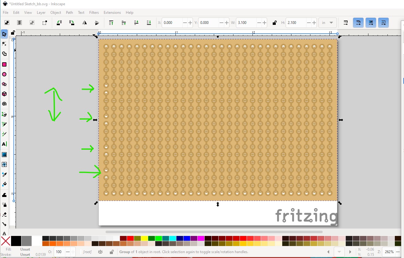

then swapped the image in vertical which displays it from the bottom like this
which shows the cuts from the bottom which is I think what you want.
