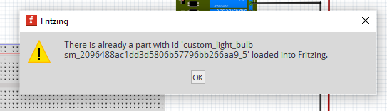

It is trying to tell you that a part already loaded has the same moduleId. If you upload the .fzpz file for the custom_light_bulb part (upload is 7th icon from the left in the reply menu.) I can change the moduleId so that part should load.

The error message is saying that there is already a part loaded in to Fritzing that has the same moduleId. Either you already have a copy of “custom_light_bulb” loaded (the most likely as it doesn’t appear in core parts) or there is another part that is using the same moduleId (which would be an error in the part.) From the format of the file name it is most likely you have a copy of custom_light_bulb in your mine parts bin like this
So click on the mine tab in the parts bin and see if the custom_light_bulb appears in the window. If it does the part is already loaded and you can drag it in to a sketch (but will get the error message if you try and load the part again.)

This corrected part should work better than the original one.
Incandescent light bulb small-fixed.fzpz (5.0 KB)
