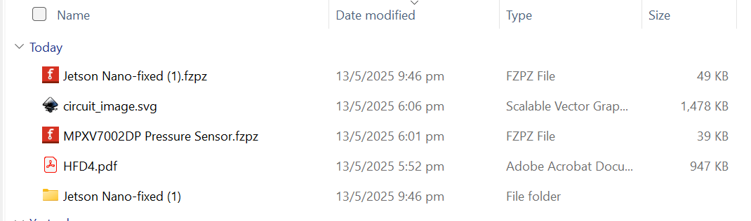

The first thing to check would be that you have write permissions to the path specified. The most likely answer is that it can’t write the file. Try writing a file to the specified directory (which should look like this, although this is Win10 not Win11)
capture

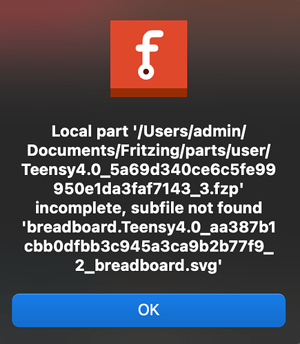

This is the error I get.
incomplete, subfile not found 'breadboard.Teensy

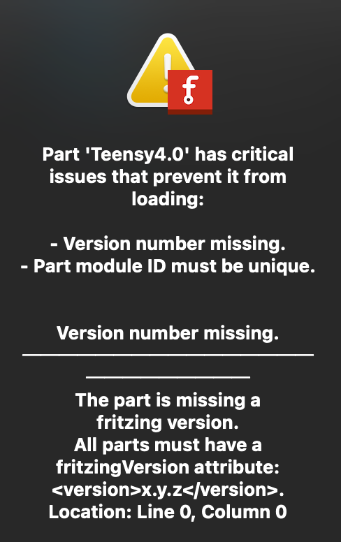

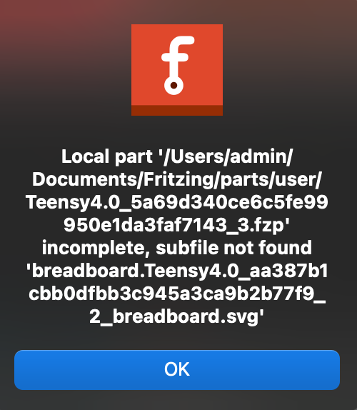

Hello Peter and thanks for your quick reply.
I get two different messages (see attached).
I use a mac with IOS 12.6
Fritzing 1.0.5 reinstalled today.
Let me know your thought, thanks!
Please attatch the .fzpz file
This is a bug in Fritzing 1.0.5

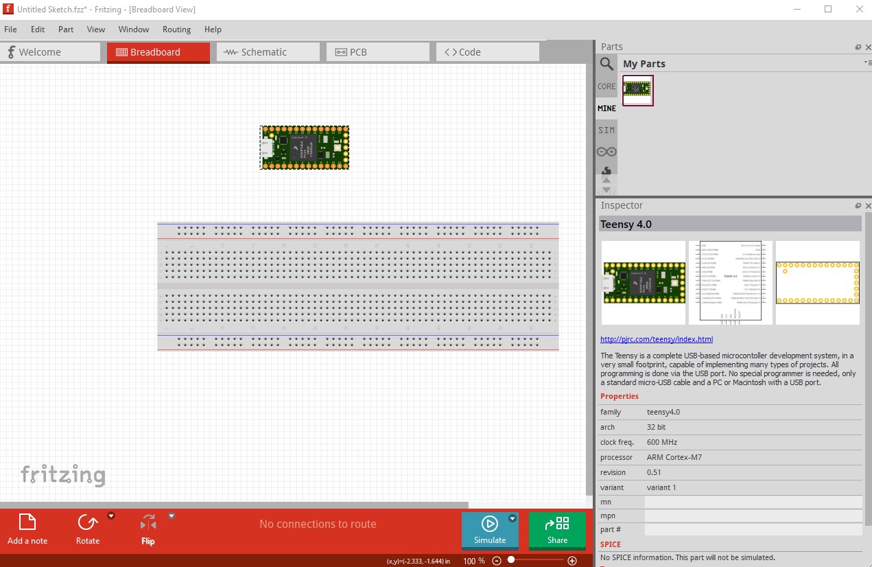

It appears the part you are using is broken. For me on 1.0.5 on Win10 the teensy-4.0 works fine:
the breadboard svg missing is the main problem, the version number missing will clear and let it load if you click OK (although the original part has a correct version number, as I didn’t get such a message when loading.) @RAPTOR7762 is correct the best bet is to upload the .fzpz file (which should be teensy-4.0.fzpz, upload is 7th icon from the left in the reply menu) and then we can look at and correct as needed the part (I made the original one.) You may want to try loading this one (which is the original part)
