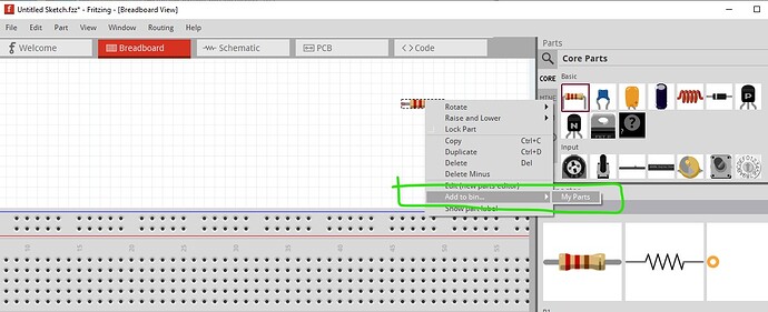

There are at least two ways. The first is to add the parts to the mine parts bin (which loading will do anyway) like this:
right click on the part and select add to bin (my parts is your only choice though.) As noted loading the part does this automatically so this really isn’t that much use. The other way is to create a fzbz file of all the parts you want, define the bin name add an icon image then import the .fzbz which will place the parts in the bin. There may be documentation for making fzbz files (or may not) there are certainly forum posts from the past about doing so (it is fairly complex as I recall.)
