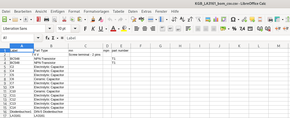

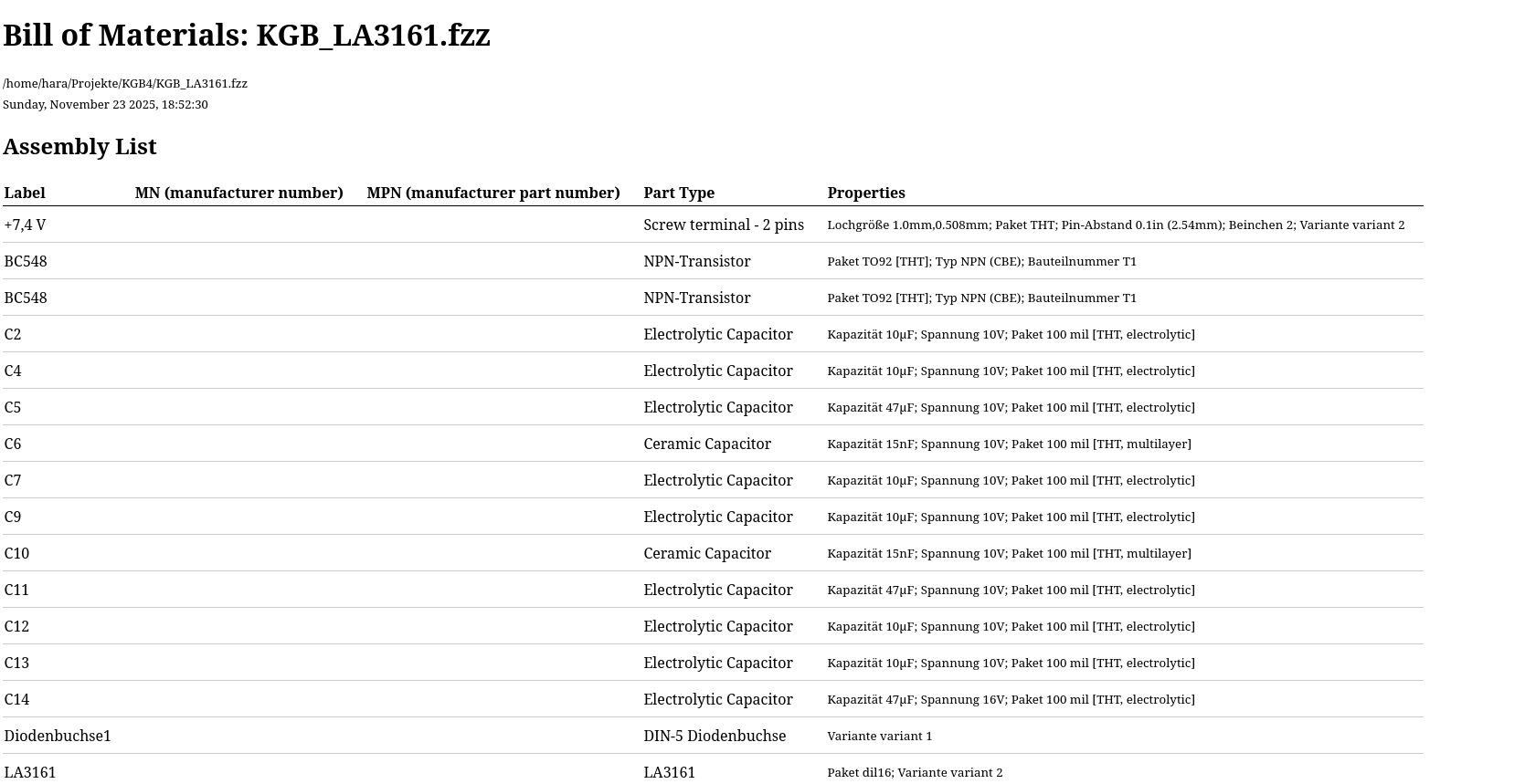

When I export a BOM from Fritzing, the CSV export is incomplete. The values for the capacitors are not displayed. What am I doing wrong?
All the data is present in the HTML export.
csv in LibreOffice:
hmtl in FireFox:

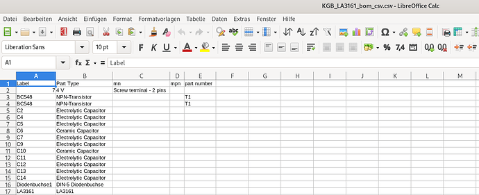

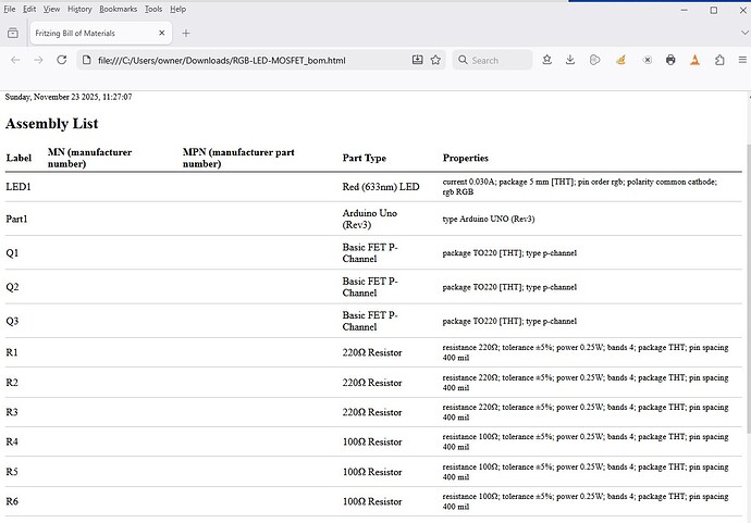

csv in LibreOffice:
hmtl in FireFox:
Gruß Harald!

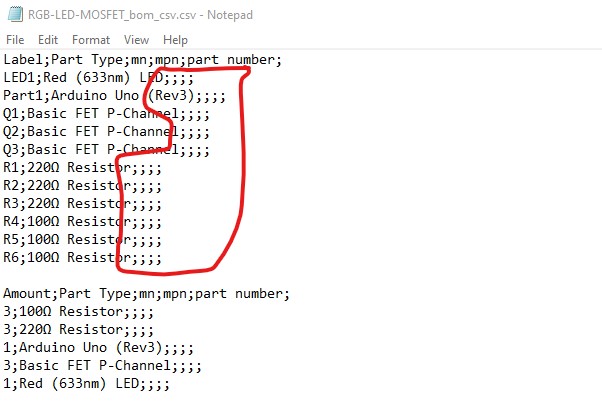

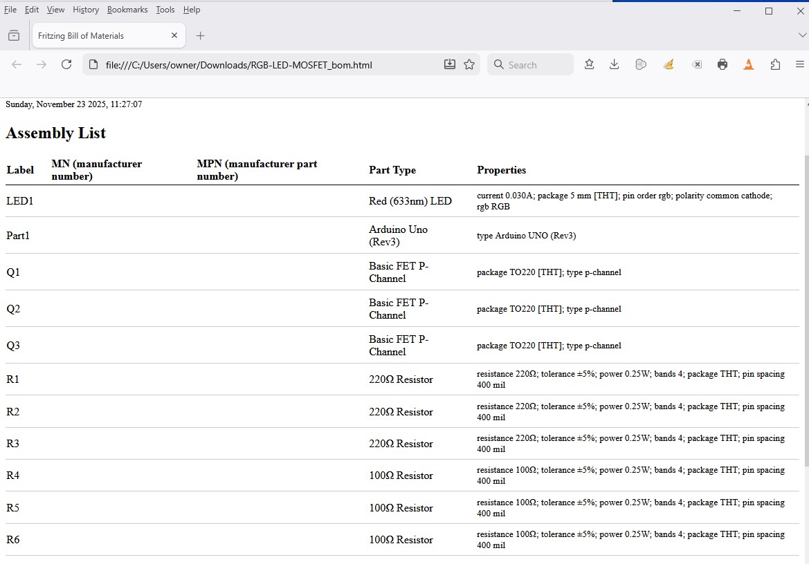

I just tried the BOM export on 1.0.6 on Win10 and it does the same as you are apparently seeing:
html output:
corresponding csv output (missing all the properties!)
So I expect it is working as designed (although this is the first time I have tried a BOM so I am not sure!) Which means that you likely need to wait for 1.0.7 for improvements and I don’t know that this is on the list. You might ask in the above issue on github to see if this is included in the intended upgrade.
