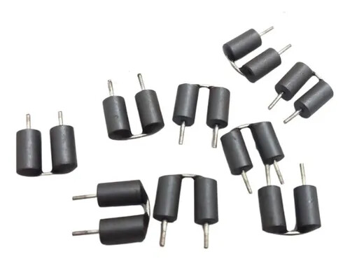

The first thing it needs is a bus to connect the two pins together. From the picture (I haven’t looked closer) there is a wire between the pins which is not reflected in the part.

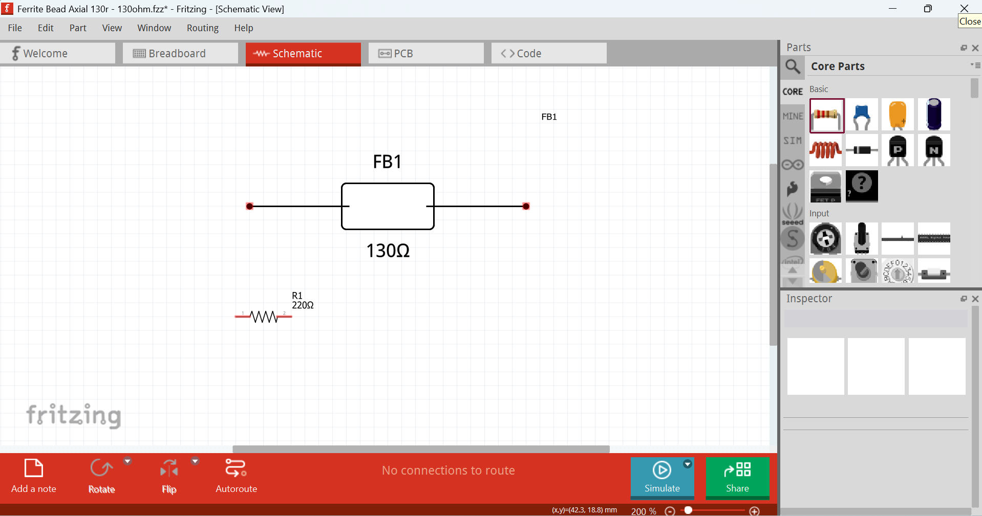

At a glance
Breadboard is fine at first look
Schematic is too large (with reference to a generic resistor)
PCB is fine

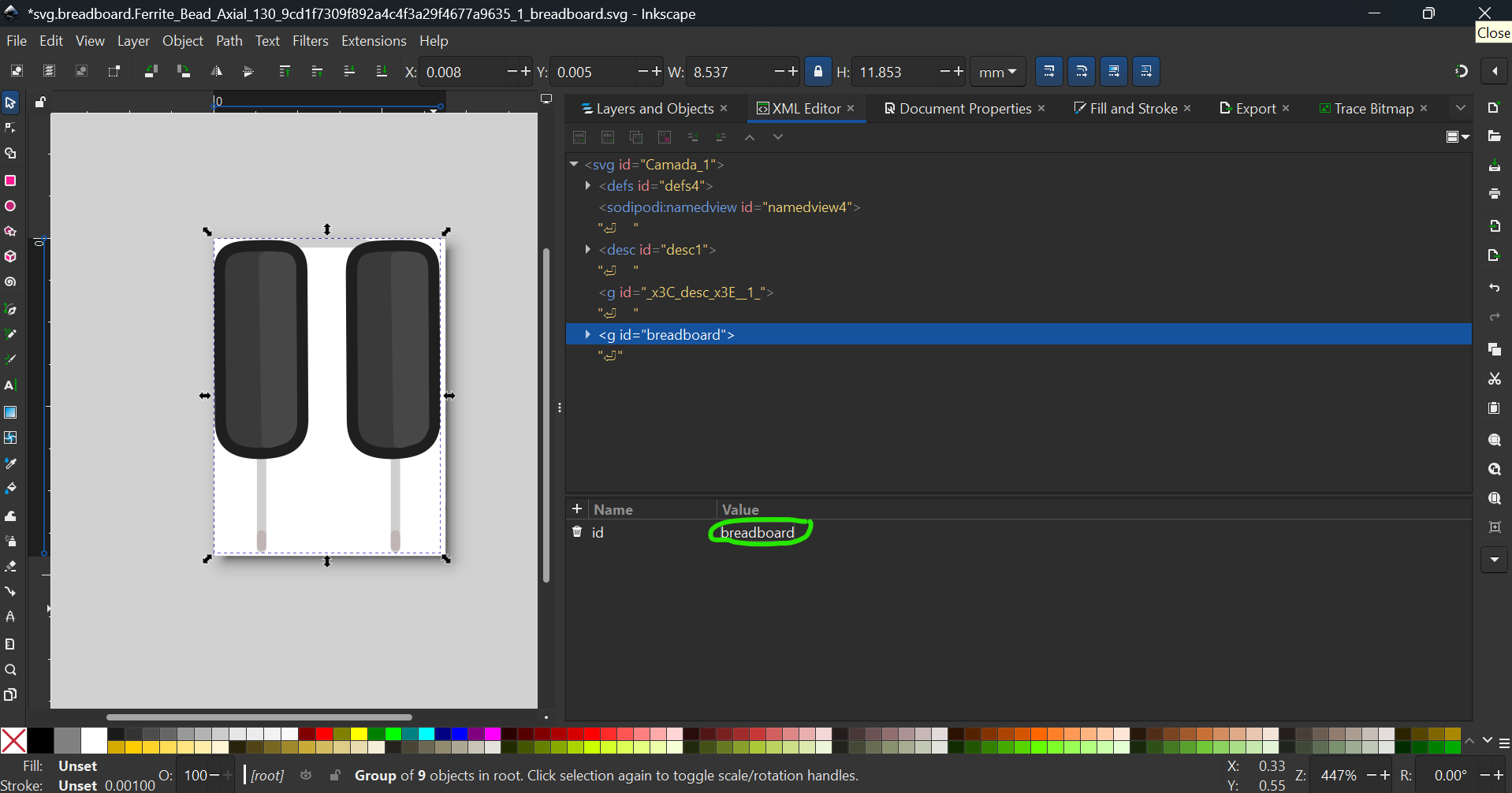

First, unzip the part

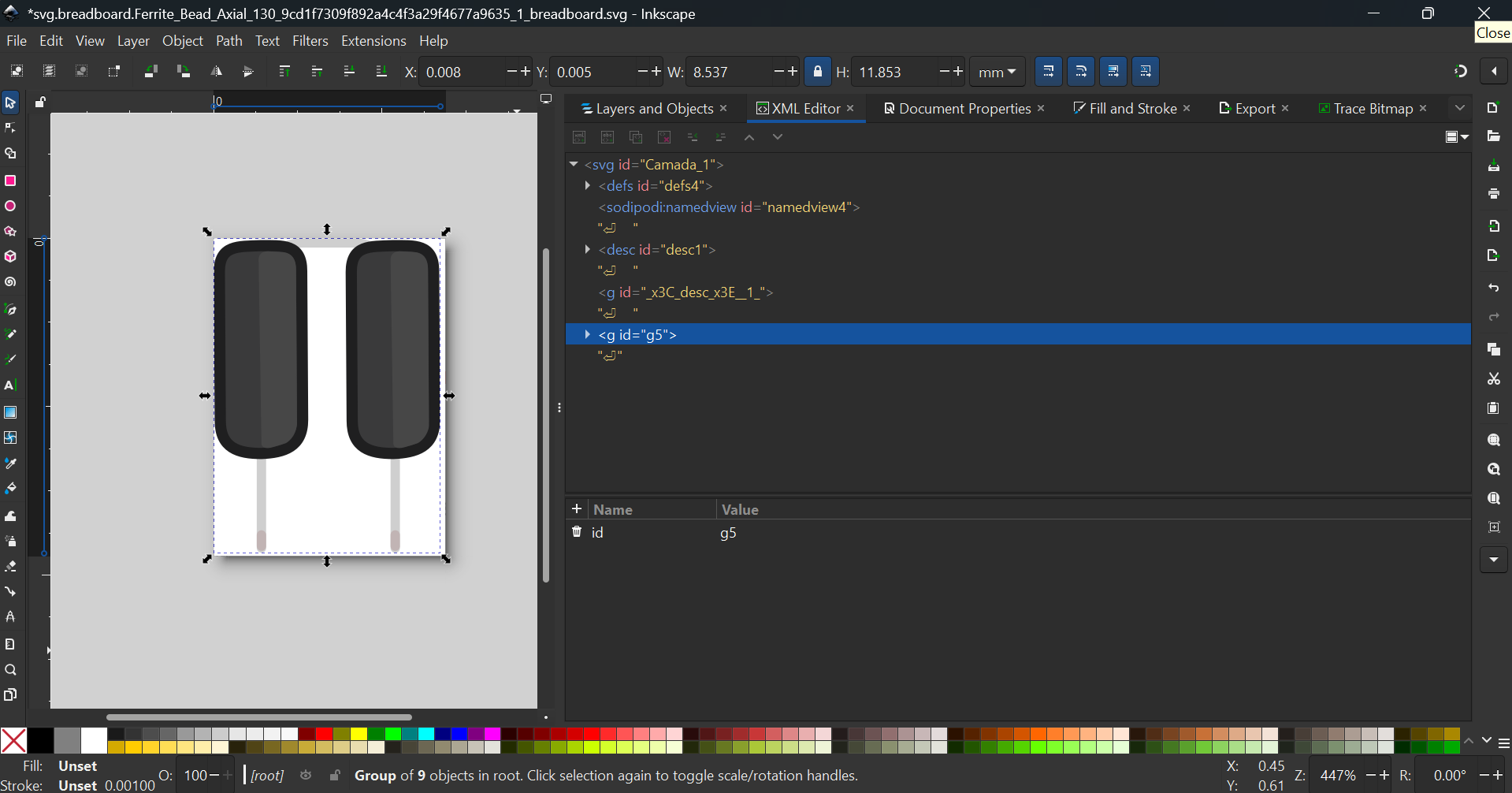

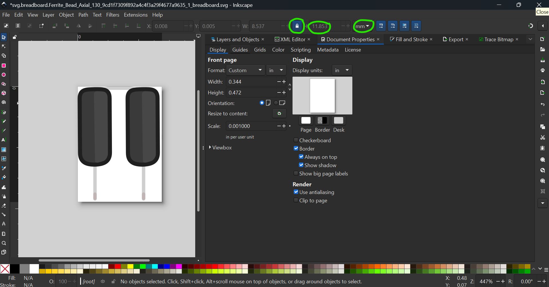

Breadboard

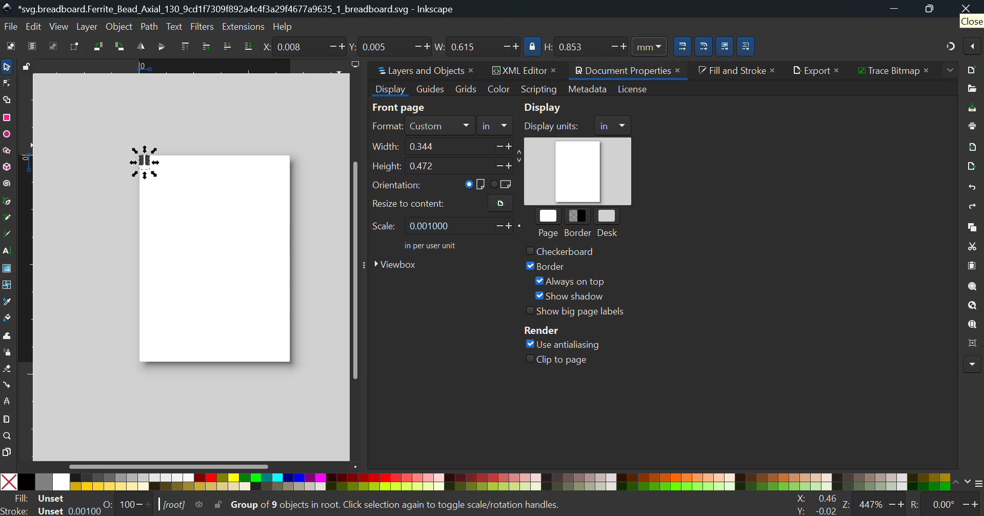

First, most (or rather in theory should be all) of the Fritzing parts are at 0.001in scale, so just fix it up
With height and width locked, resize it
(note that I used mm to resize the image for higher accuracy.)

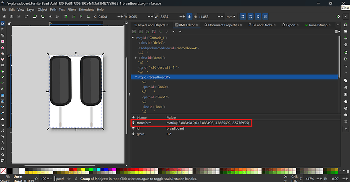

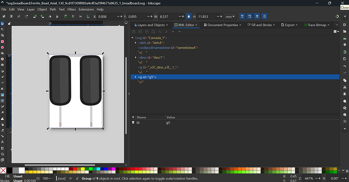

Now ungroup and regroup to remove the transforms
ctrl+shift+g (or cmd+shift+g on mac)
ctrl+g (or cmd+g on mac)
Rename the group
and save the file.

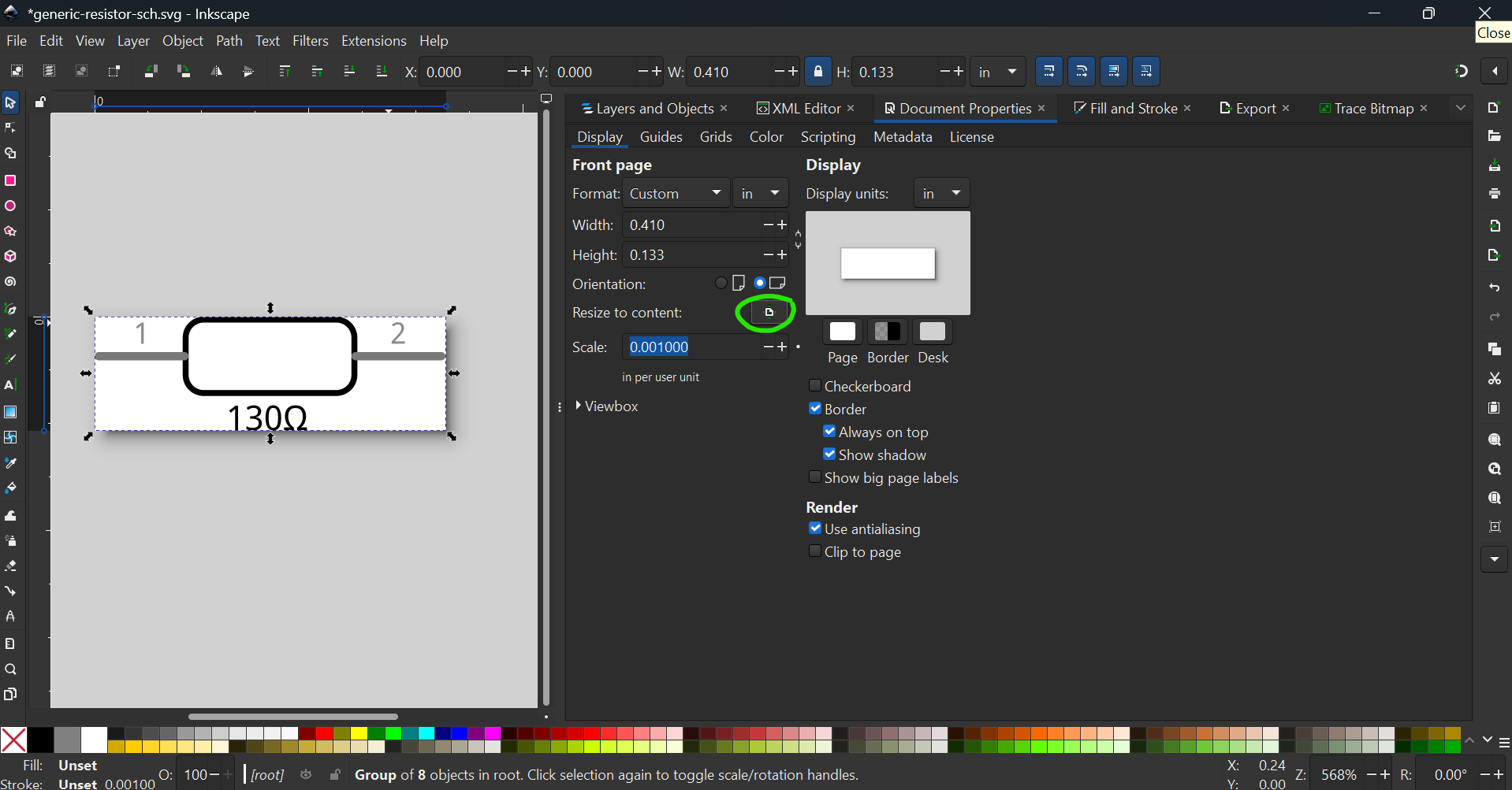

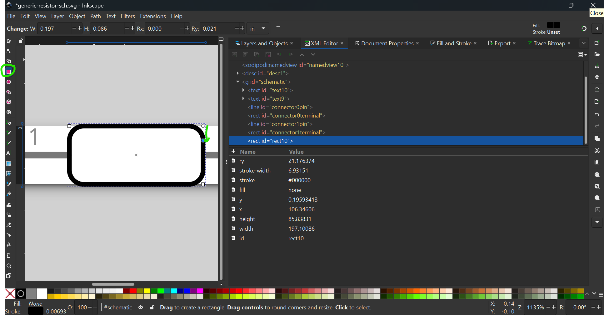

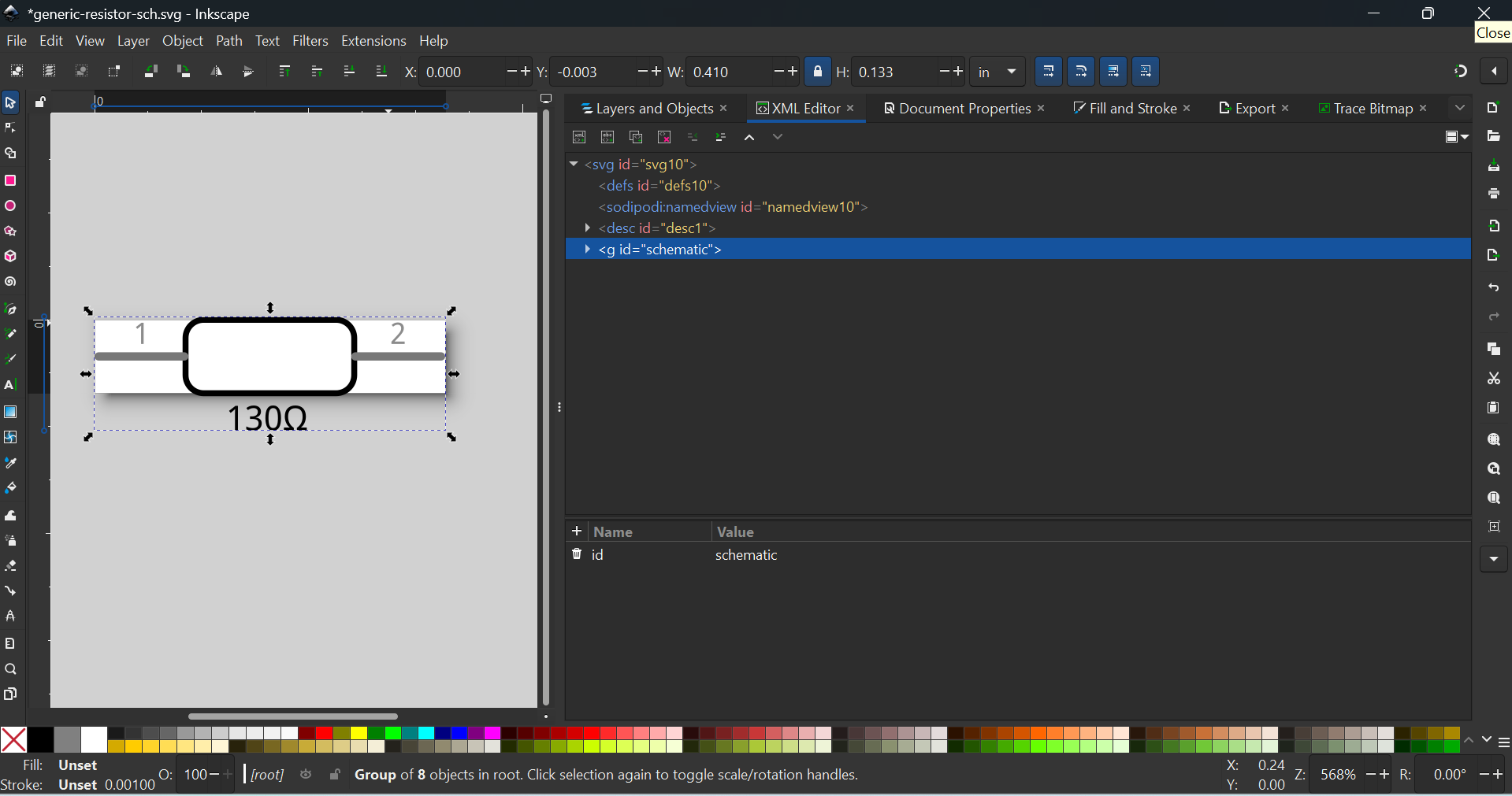

Schematic
First, download the SVG below as a template for this part
generic-resistor-sch.svg (5 KB)

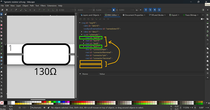

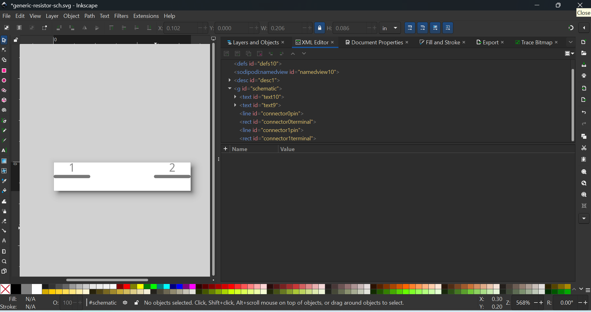

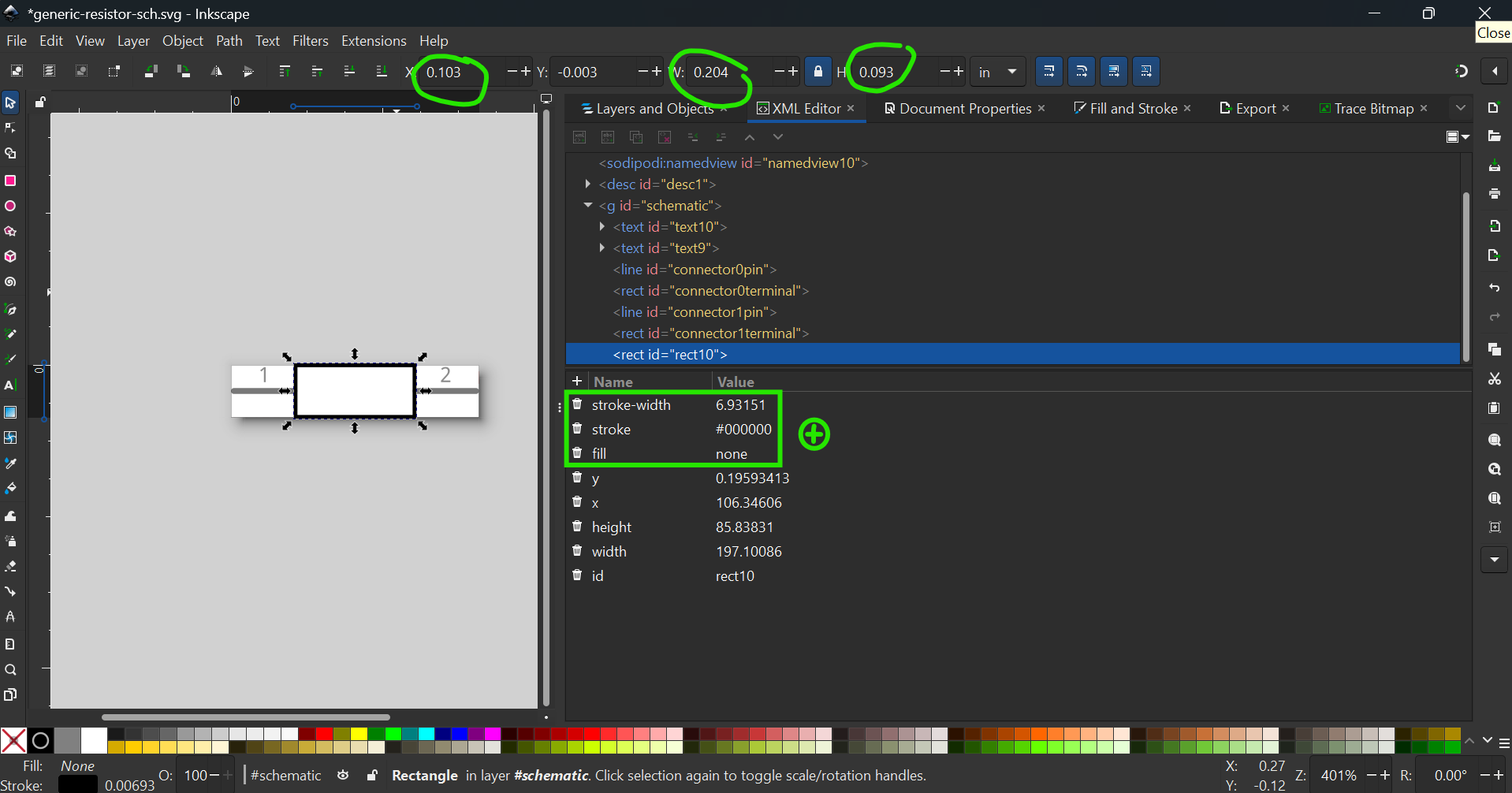

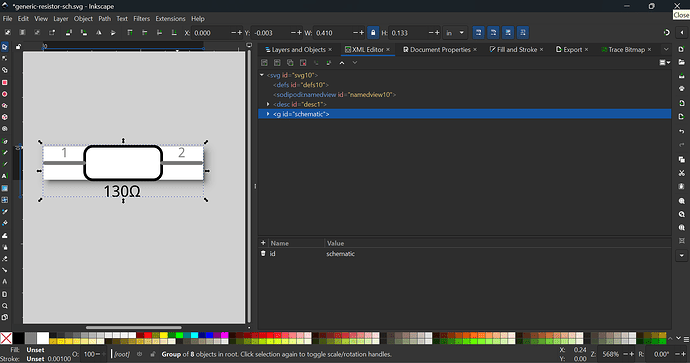

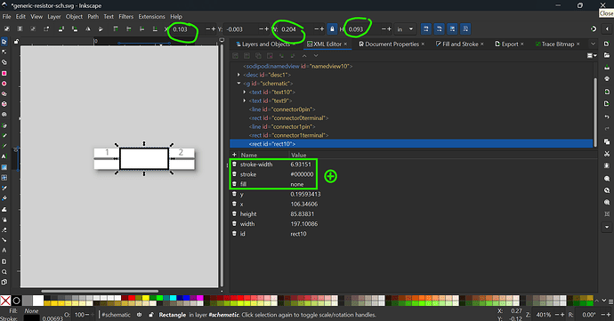

Next, open the file, rescale the SVG (documented in step above), and delete all the resistor lines
Draw a rectangle
You can curve the sides a bit

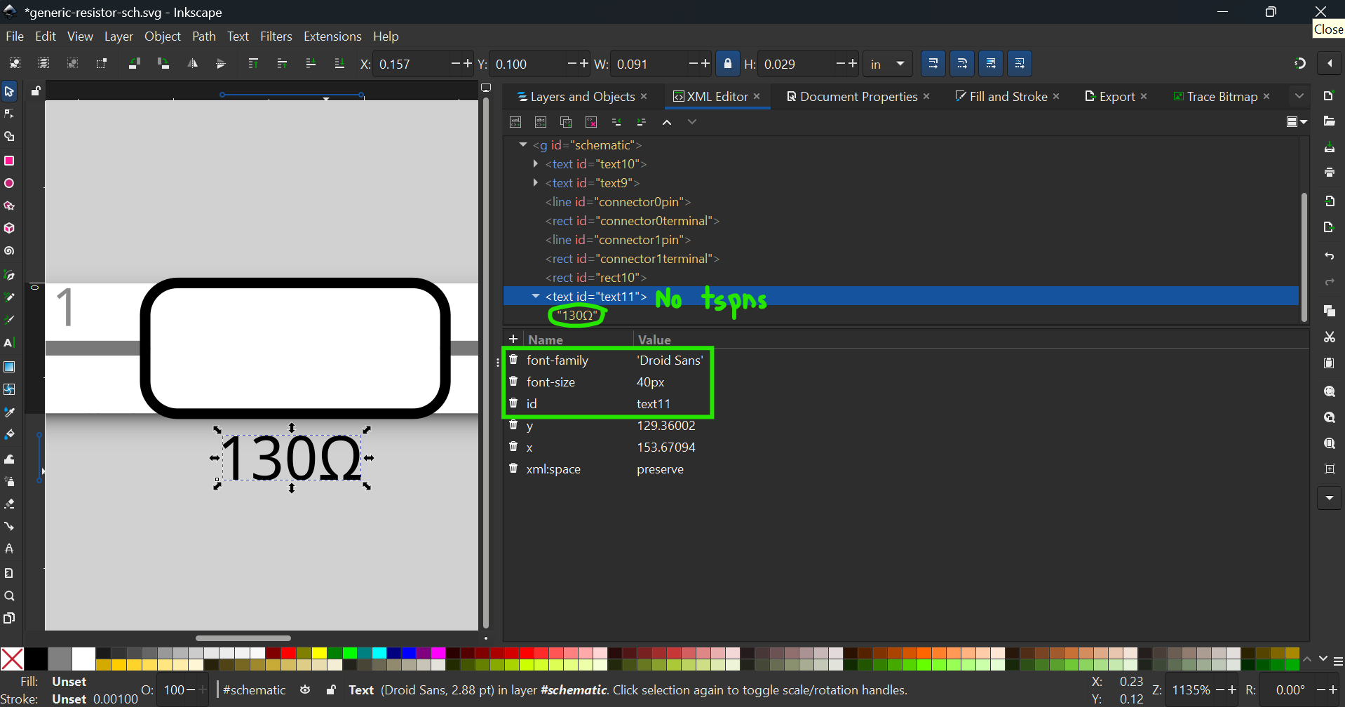

add text (droid sans)

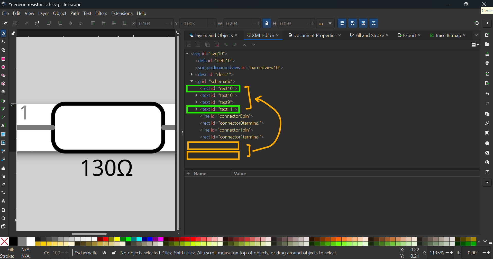

Rearrange the order
Resize the viewbox
Ungroup and regroup the main group. Save the file, and you are done.
