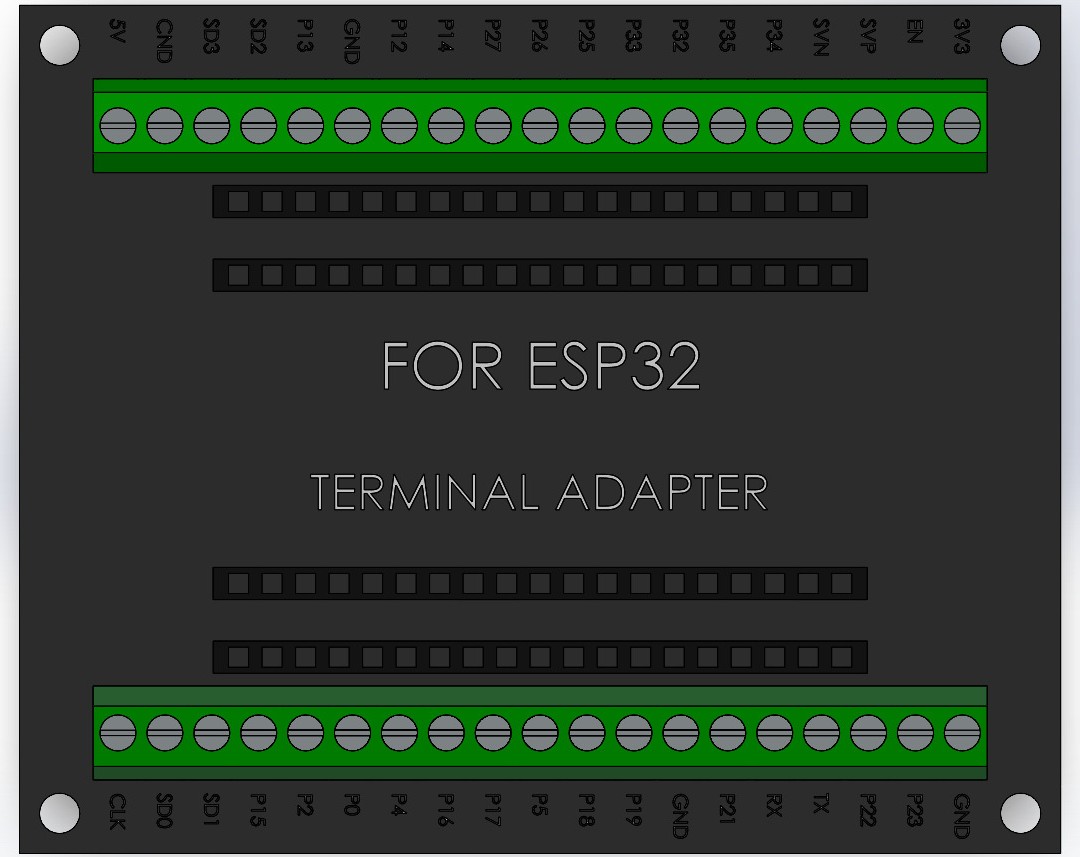

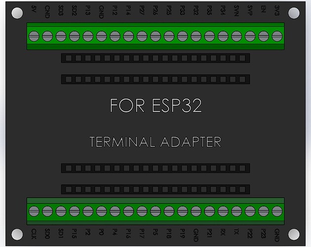

38-pin Screw Terminal Adapter for ESP32
38-pin Screw Terminal Adapter for ESP32(1)
Insufficient information to do anything with. Pictures of random parts are useless when requesting parts. That is why there is a template (which you look to have ignored) in this category. A web page with physical dimensions and connections is required to identify a part if it exists (a google search of the form “fritzing part part_name” where part name is the part you want is also a good start.

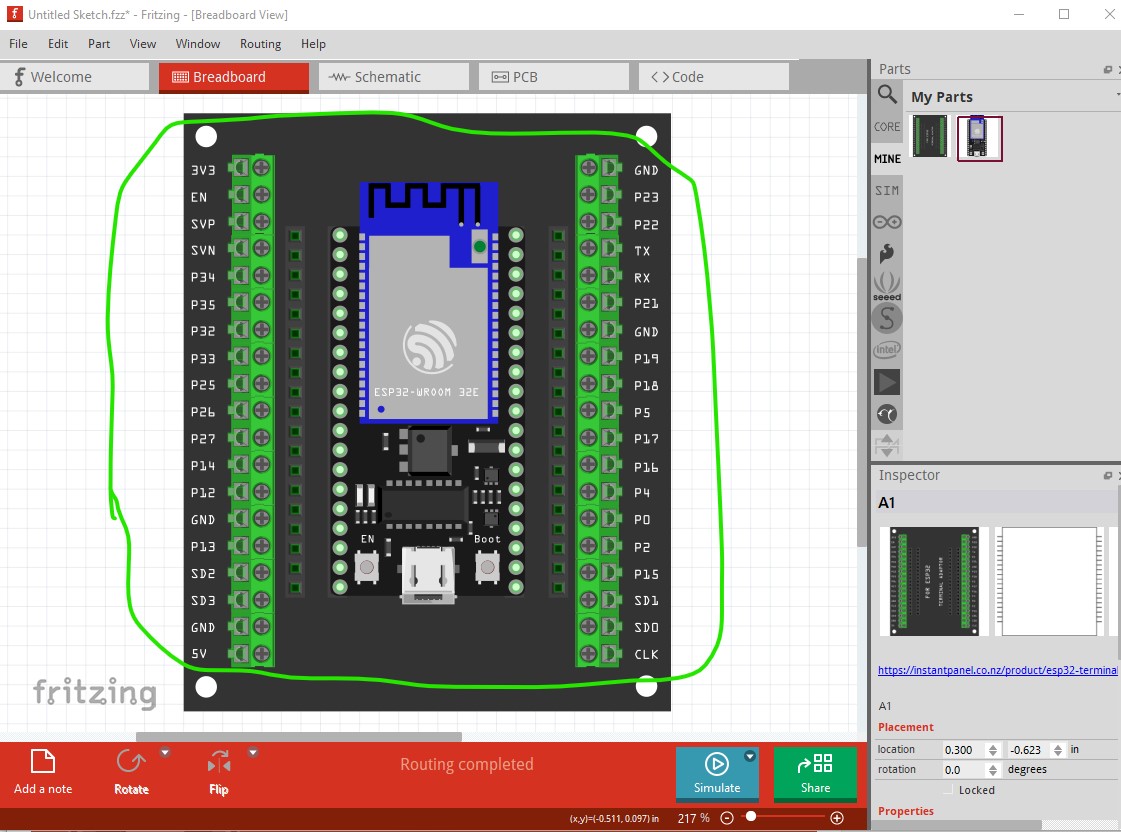

This part should do what you want. Note if you drag an appropriate CPU board in to the pads in breadboard like this (note the green connected pins)

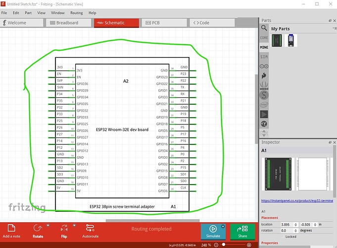

The cpu board schematic (assuming it is properly formatted) will appear in schematic like this
some cpu boards will have oddly formatted schematics and this won’t works but it does for several that I have. The outer connectors are the screw terminals where you would connect your external components. Pcb view in this part has been suppressed as not useful (the pads of the cpu board are the appropriate thing for pcb view.)

Thank you, Peter. It was exactly what I needed
