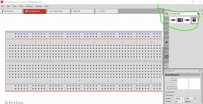

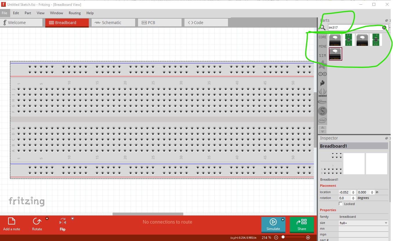

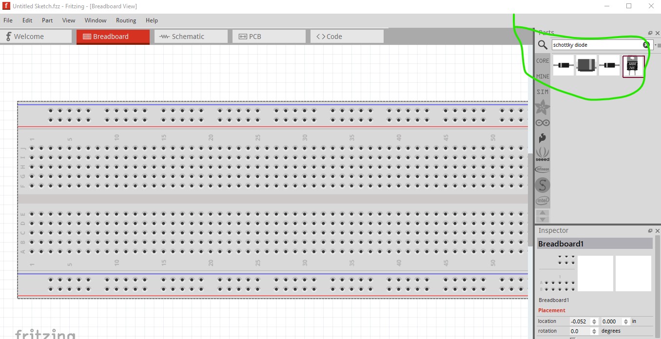

Both are available in various forms in core parts.
For the diode you can change the part number by setting it in inspector (the lower right window.)

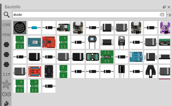

Hi,
if you type Diode into the search bar, quite a few components come up. Do you have the part number for the diode?
…or do you need it for a simulation?
What’s really important is the physical size of the component for making a PCB later. The electrical properties aren’t that critical for that.
Regards, Harald!
