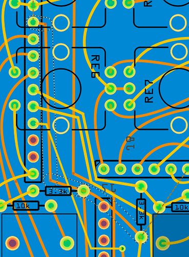

Adding a screenshot. here one sees two traces selected. It’s not possible to select section one or two. You only get both. This is not good.

On the third try I managed to get it. First removing both traces. Then from header to 3.3k. Place trace in the background. Then place next trace from 3.3k to the other 3.3k (bottom) which automatically went top. fine. Why are traces sometimes treated as a whole? It’s a right pita.
Yep appears to be a bug. It was introduced between 1.0.3 and 1.0.4 it appears. 1.0.3 reacts as expected the trace stops at the first connection when moved from top to bottom.
in 1.0.4 and later it changes the entire trace which looks to be incorrect..
