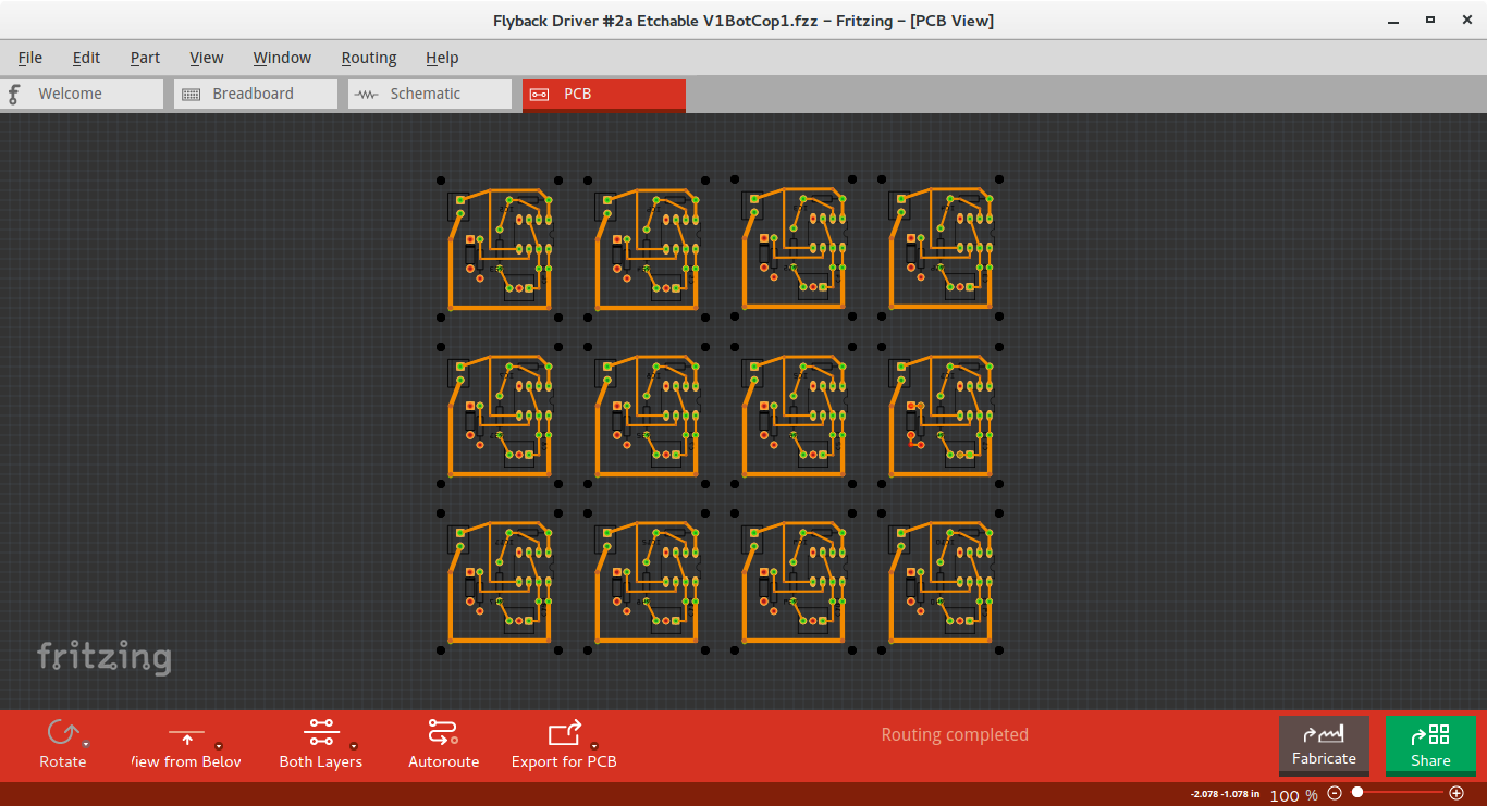

Screen Shot Attached:
/home/syd/Screenshot from 2016-03-13 08-22-27.png
