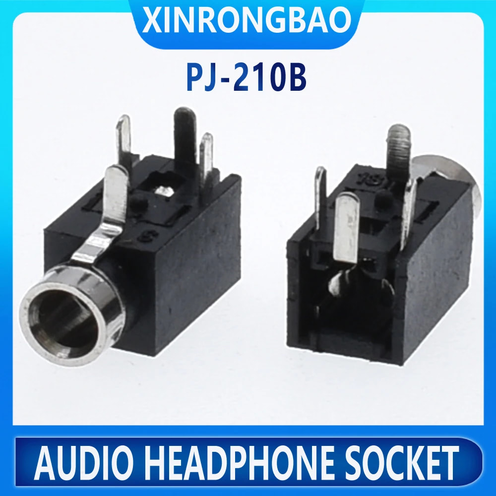

I’m searching for following part in Fritzing, anyone could help me?
PJ210B

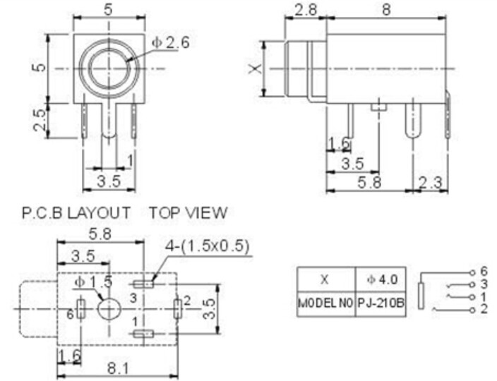

I don’t have any top view
I have a similar jack here that can perhaps be modified. Could you please add the link to the datasheet?
I think only the PCB view and the schematic need to be adjusted.

Hi Andrea,
Is this already the solution? Doesn’t the schematic need to have four connections [1,2,3,6]?
I read up on it again. Contact 6 is important for detecting, for example via software, whether a headphone is plugged in.
If you’d like, I can adjust it, but if it’s fine as is, then I wish you the best of luck with it!
