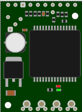

@vanepp Is there a chance to download the full fzpz package of the Pololu Dual VNH5019 board somewhere?
That part is in Fritzing core. At least I find it when I do a search for ‘motor’
i think @vanepp is not active yet, maybe @RAPTOR7762 can help with the full download?
I only can find this one:
But this is not the actual one as it seems if you compare it with the model from vanepp and the pololu website: https://www.pololu.com/product/2507
Strange. For motor or H-Bridge I get lots of hits. Did you try downloading the file from here? https://forum.fritzing.org/uploads/short-url/6VEnqD3XBN0Dw702UP3rr4qNf9d.fzpz
I’m not searching the VNH2SP30 but the VNH5019 that vnepp mentioned.
