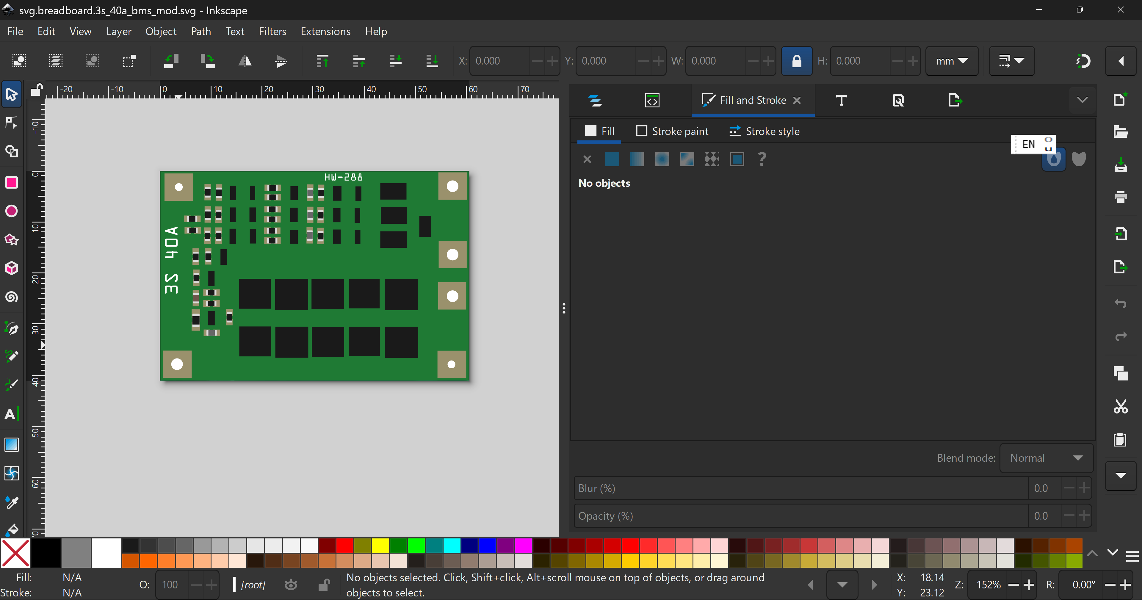

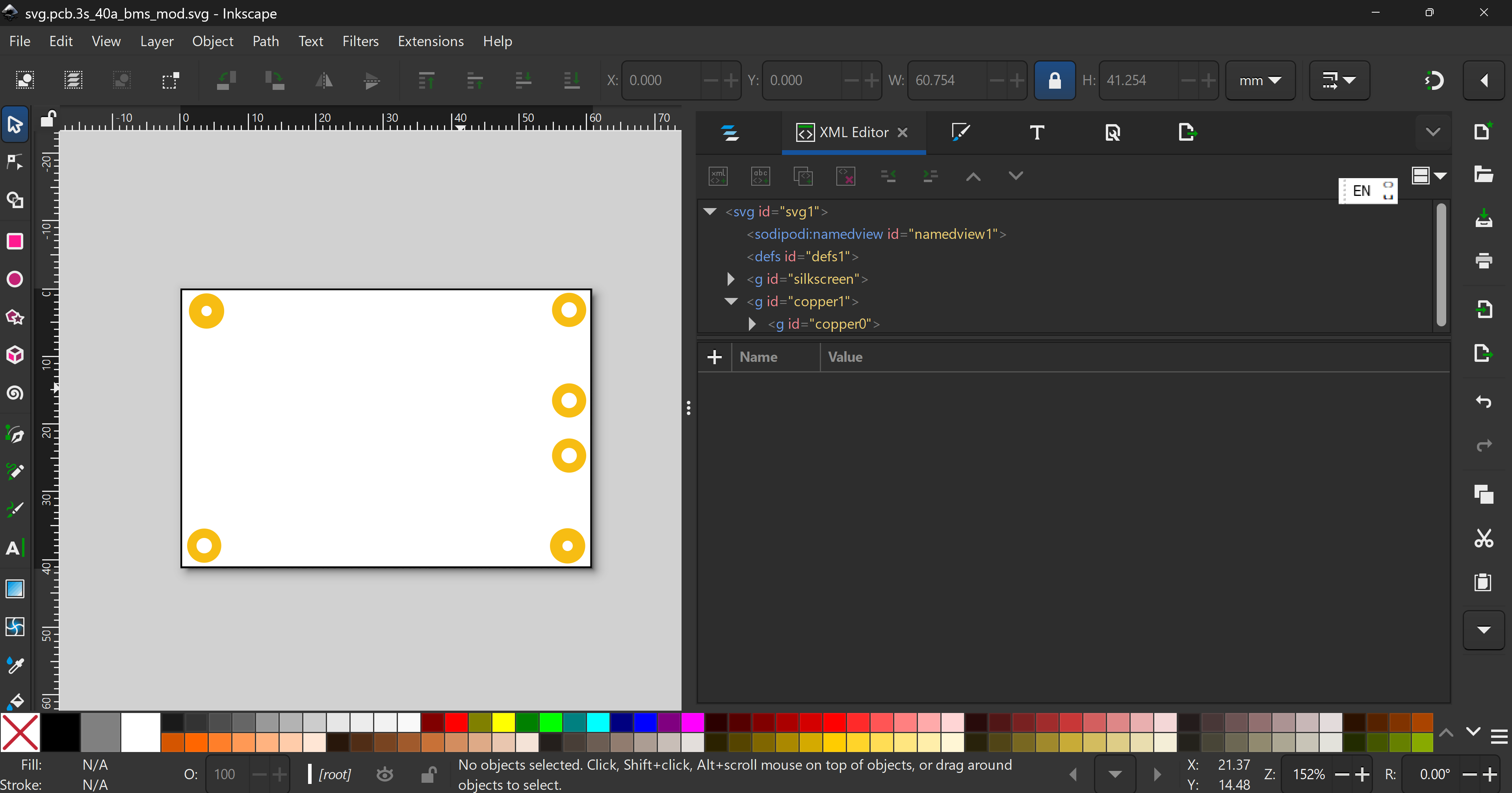

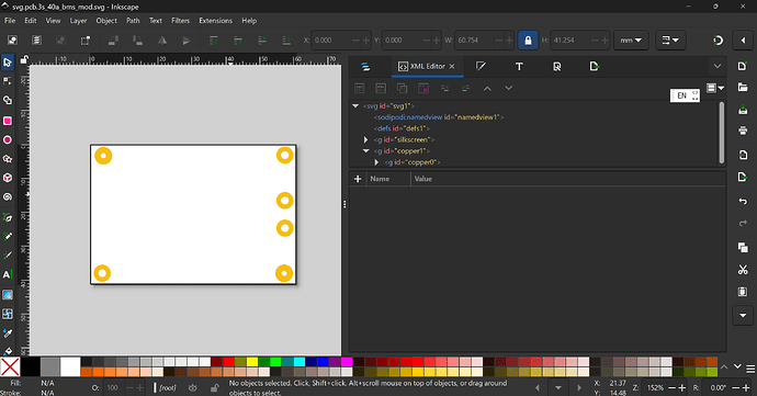

@RAPTOR7762 .If I may ask something about the design, can I move the ports on this PCB view? This part is already available in the previous forum, if from the breadboard view and the schematic view everything is in accordance, but for the PCB view I think it is confusing
and this is the link i was referring to, any hints on how i can fix it?
im not sure if the dimension of the module is similar with my module, i think i can solve that dimension, but at least i must fix the pcb view for the first
Hi @Saniy_Haffiyan
This requires some SVG scale (in case you don’t no what SVG is, just quick read this
thank you very much @RAPTOR7762 !!! From the source you provided and some AI guided, I have been able to fix the PCB and schematic designs. :handshake:

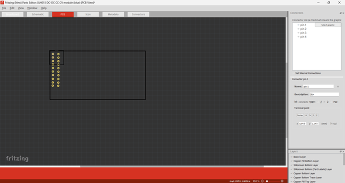

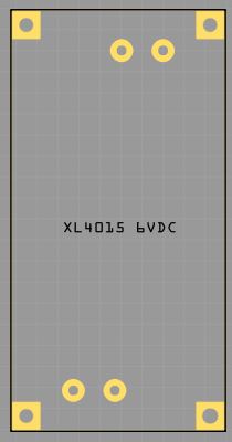

But @RAPTOR7762 , did you spot any errors or mistakes in my edits?
I’m very open to any criticism or suggestions you might have about errors. After all, it’s important for me to improve my skills.
And um, maybe if you want that part, I can attach the file I have fixed to you.
(PCB view for the XL4015)

this an attachment for the XL4015.fzpz module:
XL4015 DC-DC CC CV module (blue).fzpz (17.1 KB)
