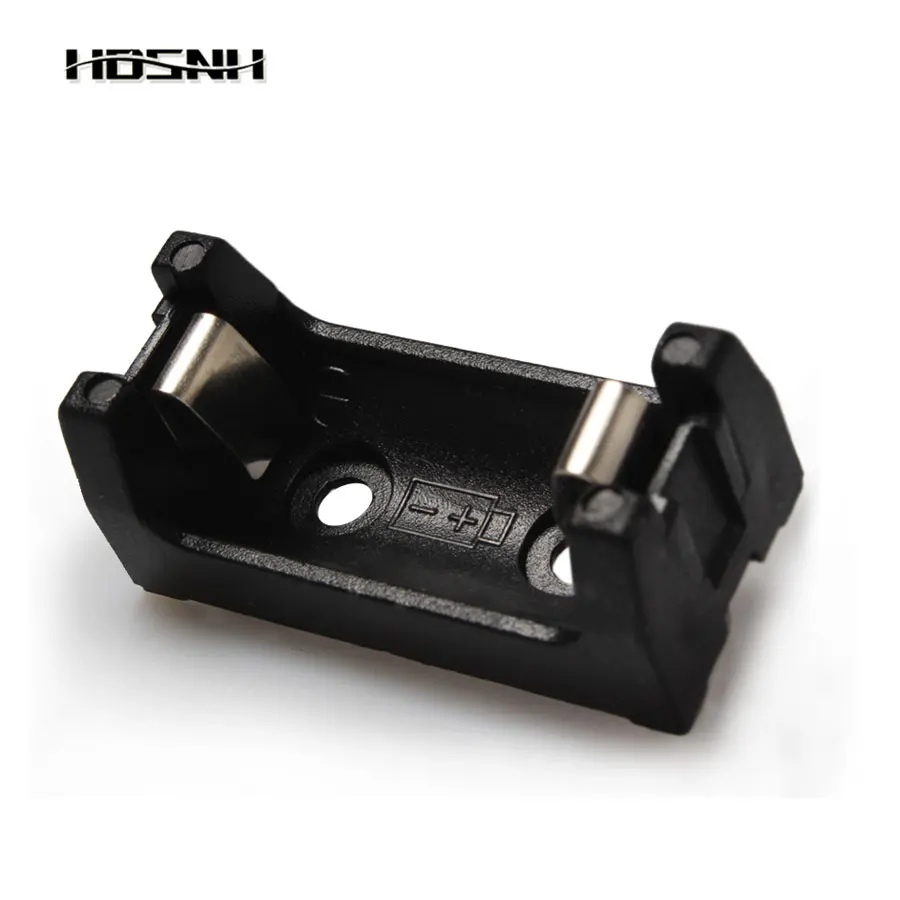

Hi, I’m looking for a ER14250 battery holder for my PCB for this kind of battery:
This is what the battery holder looks like:

This should do the job. As always check the footprint against a real part before ordering boards. The two 1/4 inch holes are only on silkscreen, if you want them drilled you need to drag a hole over top of them to drill the holes (the mounting pin will get drilled though).
