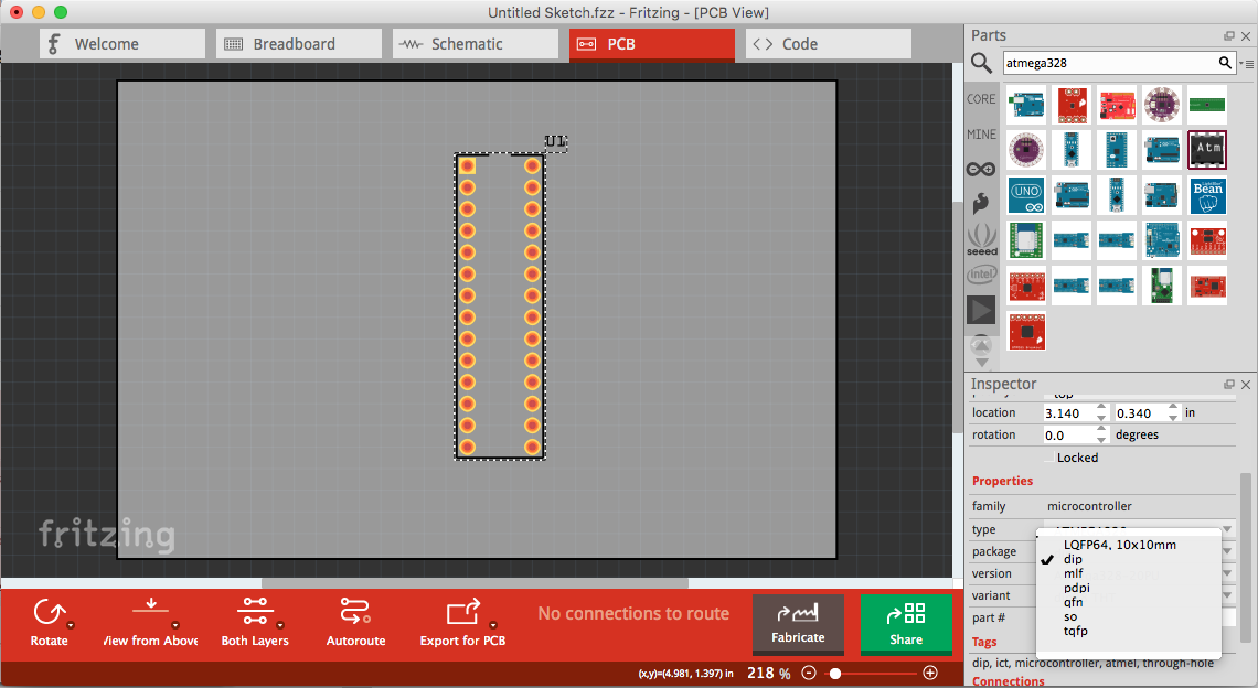

In the bottom right, you can see I was trying to change the package of the Atmega328. I can change it a few times without Fritzing crashing, but then it randomly crashes when I try to change it.
What I expected should have happened instead:
The package should have changed and frizzing should not have crashed.
Thanks, that one will be hard to track down… I don’t think it’s the new access protection you’re mentioning, since we’re not doing any file system operations for that function.
sorry, i tested it for 5min swapping the atmega between all packages and variants without any crash.
but i am on win7 64bit. maybe really just osx el capitan?
I can confirm the crash on El Capitan. I think it’s because the “part swapping algorithm” is getting confused by the duplicate properties here:
This is because in the core library we are using package and type, while the SparkFun library uses variant and version. After clicking around a bit, it ends up in an instable state:
The next property change then leads to a crash. The way to fix it would be to make the SparkFun parts also use package and type. @fa1, can you take care of that?
